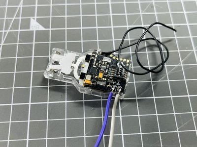

Step 2: Damage and Chip Burning Conditions:
Note: After the module is connected to the DC power supply, it is forbidden to press the power push button since the generated excessive energy may burn the chip. When pressing the power generation button or using DC power, at least one of the dip switches on the module must be dialed up, otherwise the chip will be burned. Press Frequency should not more than 4 times per second, continuously rapid press will cause energy accumulation that cannot be consumed in time, and eventually burn the chip.

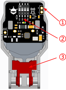

Step 5: Connections and Pins:

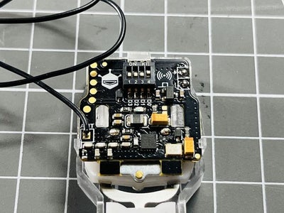

1. DC input terminal The DC power input terminal, 3.3V-5V, can transmit signals directly after being connected to the DC power supply. Used to pair with the receiver.
2. DIP switch Key value selection, dial up to select, from right to left is D0-D3, One must be dialed up when using.
3. Power Push Button Generate energy when pressed.
Step 6: Transmission of Codes From Transmitter Side:
There are 4 DIP switches on the PCB, these switches are used to select the channel. 16 different combinations can be made with these 4 DIP switches. Receiver part also has 4 channels, it recognizes the combination of DIP switches on the transmitter end and turns on the respective channel. All the 4 channels can be activated at the same time if all the DIP switches in the transmitter are in ON state. To change this behaviour of the receiver see the Mode switch part of this tutorial in detail.

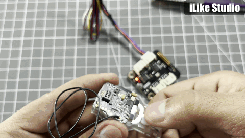

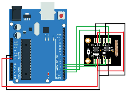

Receiver: Upload the pairing receiver code in Arduino UNO and Connect the receiver with Arduino Uno as shown in the schematics below.
#define Button_D2 2 //Arduino
void setup() {
Serial.begin(115200);
pinMode(Button_D2, INPUT);
void loop() {
if (digitalRead(Button_D2)) {
Serial.println("Pressed:D2");
delay(1000);

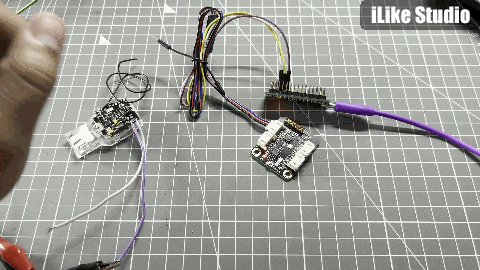

Transmitter: Dial all of the DIP switches on the self-generation switch to the top (To avoid misoperation, the D0 terminal will be toggled up at the factory). For pairing we need to attach a battery with this transmitter unit. After pairing, the transmitter can be used without battery. Press the button on the receiver, the receiver will turn on a blue light at this time, and enter the waiting state for pairing.
Connect a 3.3-5V DC power supply to the upper right corner of the self-generation switch, and the self-generation switch will light up in red at this time. Wait for the blue light of the receiver to flash three times and light up again, then the pairing is successful. Disconnect the 3.3-5V DC power supply from the self-generating switch and wait for 5S to release the stored excess power. Press the button, the receiver will receive the signal at this time.
The receiver pairing waiting time is 6S, if it does not receive the transmitter's pairing signal within 6S, it will automatically exit the pairing mode. If the pairing fails, repeat the first two steps. You only need to pair any one of the transmitters D0-D3, and the other three will automatically match.

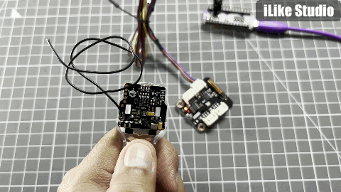

Step 11: Example of Receiver With Arduino:
Upload the main receiver code in the Arduino, and connect the receiver with arduino according to the given schematics.
Any combination of DIP switches on the transmitter is able to produce the same output on the receiver side and the operation can be manipulated by the arduino hence a faithful wireless communication set between the TX-RX pairs. Checkout your custom made PCBs now and get best prices on PCBWAY. Sign-up now and get free coupons for PCBs, 10pcs of 2layer board in just $5.
