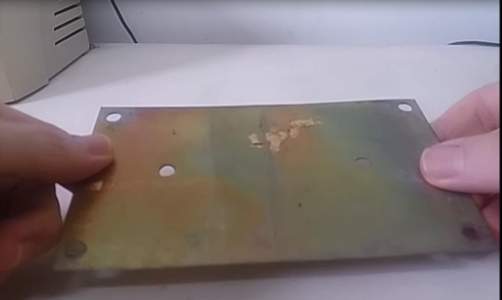

- A piece of steel sheet , about 3 x 3 inches, only to keep the bolt standing. Dimensions are not critica again.

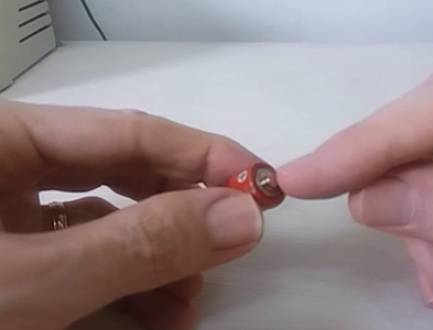

1-Start off by removing the positive pole of the battery with the help of pliers and a fine screw driver.
2- Solder the positive pole to the magnetic wire. Do not forget to remove the enamel with a sandpaper or burn it with matches. If you don't have a welder you can try to glue (superglue) the magnetic wire to the positive pole, but you must be sure that there is electric contact between the pole and the wire.

- Now with the help of two neodimium magnets, mount the bolt on the steel sheet piece , and be sure to keep the magnetic wire as close as possible to the side of magnets (see the picture)
- With the help of insulating, keep the magnetic wire on its place fixing it on the steel plate. This is necessary because whe magnet wire on the side of the neodimium must not be an obstacle to the spinning loop.

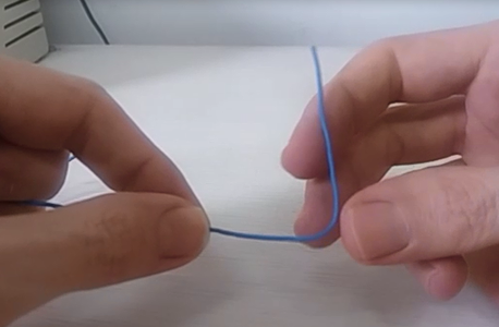

Step 4: Make the Wire Loop
- Everyone who tried to make an homopolar before knows that there many shapes for the spinning loop, in my case this shown on the picture was the one that worked best. Since the cellphone charger has limitations on how much current it can provide you must consider that the loop must not impose too much friction against the side wall of the magnets.
- The exact dimensions of the trinagular loop are no critical, since they depend ont the length of bolt you are using.
- be sure, on the upper contact of the loop, to remove the insulation in order to allow the electric current pass through it. Of course, remove the insulation on both ends, in a way that barely touch the sides of magnets.

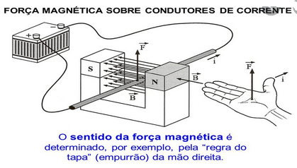

Step 6: How It Works?
- Many people make homopolar motors like this, but I see that sometimes they don't fully understand how it works, and then, they cannot understand how three phase induction motors work as well... they do not understand the principle behind it. And that is why I consider this motor beautiful in its simplicity but huge in its wisdom.
- It has to do with a phenomenon that appears when a wire conducting electric current (or charges in movement) experiences when it is in immersed in a magnetic field: It appears a perpendicular force pushing it. So, in a motor this wire is placed in a position that this force trnslates into a torque which makes the loop to rotate. It has to to with the Lorentz force.
- There is a practical rule known in electromagnetism as "right hand rule" (I know in some places the use other positions for the hand..) which simplifies visualization of this phenomenon. Fingers aligned with magnetic field line forces (B vector, from North to South pole) , thumb aligned with dicrection of current (on the wire) and the force that appears coming out from the palm of hand. This force makes the loop to spin.
