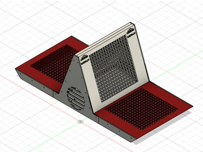

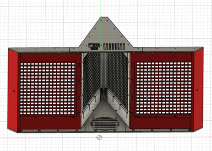

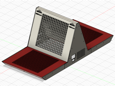

Step 1: HARDWARE DESIGN
We decided to make an original design by modeling the whole case in Tinkercad step by step. The idea was to model the typical paper boat, having the same things in each side.
Each player will have two screens: one on the top of the boat, just to watch the target map and to select where to attack, and the other one on the bottom, to see what the enemy is doing on your map.
On the front side, there will be some indicators in order to make the game easier by lighting whose current turn it is and who won the match at the final of the game.
Anyways, the 3D printing models are attached in this file to skip this step.

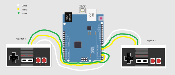

First, we have to connect the controllers into the Arduino board like this:

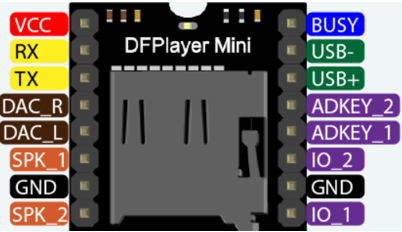

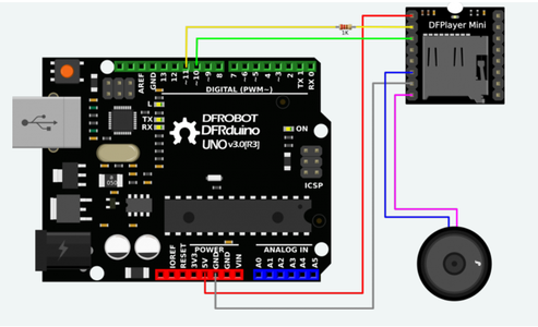

In addition, the DF Player has to be connected to the Arduino like in the image.
Anyways, all the instructions in order to installate the sound files is in the annex.
