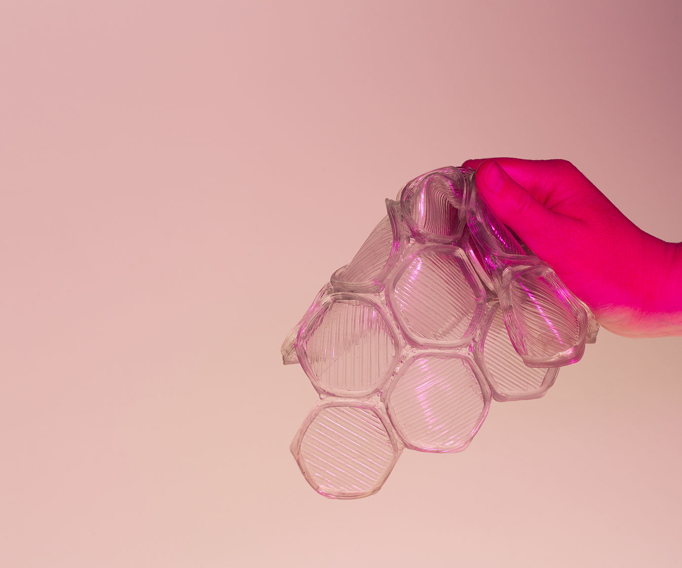

1. Spread out plastic wrap on a small area on a table. Place a metal textile on the plastic wrap and the perforated plate on top of it. Use some weights to hold down the mesh and the plate.
2. Mix the concrete; you can find help how to do so here: https://www.instructables.com/id/DIY-CONCRETE-How-To-Mix-Concrete/
3. Use the putty knife to spread the fluid concrete on the perforated plate and push it through the cut-outs. Wait a moment before you remove the plate. After you removed it, carefully place plastic wrap on top of the moist concrete. Let it dry for about one day. For some objects I ended the process after this step.
4. I combined the concrete-metal-combination with paper fibers of hemp and pine. Therefore I made some thin layers of paper in which I embedded the concrete metal and let it dry.
5. Other variations with beeswax, rice paper or a polyurethane elastomer are possible. There is no right or wrong way how to do so; it is a process of trial and error.
