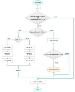

As soon as the green button is pressed, the motors start running and the car moves forward. The flowchart of car's track is sketched in the image attached.
The first thing to think about is, How to detect garbage? So, this was done using a flex sensor. When the sensor touches the garbage, and due to the forward motion of the car, it will bend indicating that there is garbage (with some delay). At this moment, the car stops, realizing it has found a garbage, it goes back 1 meter and then releases the shovel using a servo motor and moves 1.5 meter distance to make sure that the garbage is on the shovel. Then, the shovel makes 140 degrees rotation about its axis to put the garbage in the garbage collector and then it goes back to its initial position.
Now, suppose the garbage is big. How big? Greater than 10 cm (length of flex sensor). So, now, we consider anything greater than 10 cm height from surface, and obstacle. Great! Now, we use an ultra sonic sensor to detect an obstacle greater than 10 cm height.
For the case of an obstacle , the sensor detects and the car stops. It will now wait for 10 seconds to make sure its not a moving obstacle. Firstly, in the case of a moving obstacle, the car just holds for 10 seconds and then resumes back to normal working. Secondly, in the case of static obstacle then it will now stop and then turn left and then right, right and the again back to left to go back to the normal linear track. Now in order to understand the width of the obstacle so as to turn right and right formation, we added another ultra sonic sensor placed on the right side of the car. This made sure that we don't bump into obstacles.
Turning left and right on electric motors is easy. We don't need any mechanisms such as Ackerman steering method to turn the wheels. We turn right by making the right wheel go forward for 4 seconds and left wheel locked and vice versa for turning right. This method however comes with certain limitations.

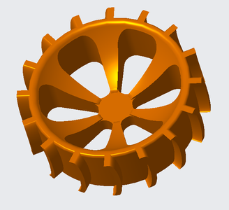

As this robot is supposed to work in sand, the choices of the wheels available for sale were very limited, and most of them had inappropriate dimensions. That's why we decided to use 3D printed wheels.
The elliptical pieces on the outer radius of the wheel will allow the robot to go forward against sand resistance.

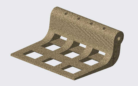

Shovel : it contains holes to filter the sand when picking up the garbage. The holes were made in form of squares so that they can be 3D printed. On the side of the shovel, in the upper part, a hole of 8 mm was made to insert a shaft. The other small holes (8 in total) were made to fix the shovel to the shaft using screws.

Secondly, our wheels are 30 mm width. It was minimum required to be 50 mm to give more traction on dry sand and also for the looks. The wheel of 50 mm was later designed and further enhanced to give more strength to weight ratio. Image has been attached for viewing and step file for reproducing it.

Finally, the shovel needed some design changes. As can be seen from the experimental videos, the shovel needed a near to perfect L shaped design so as to easily pickup the garbage. At first calculations, friction was on our mind for the L shaped shovel as there is a lot of surface to surface contact and therefore neglected on its design. Later, we designed a better shovel as that can be seen on image given. Practically it has not been tested but according to experience, we believe that the new design should work with the 24V motor.
