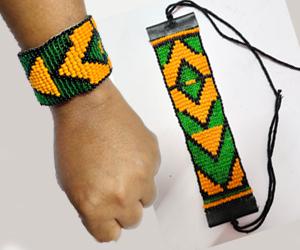

Step 7: Locking the Beads
Glue and Leather Preparation:
The first image shows a bottle of glue (Camlin White Glue) and two pieces of leather or similar material cut to specific dimensions (2.5 cm x 4 cm). This glue is likely used to secure the ends of the bracelet and reinforce it.
Finished Beaded Pattern Measurement:
The finished beaded design, measuring approximately 15 cm in length, is shown on a ruler for reference. This pattern includes intricate beadwork in green, orange, and black colors.
Folding the Leather:
The following images show the leather pieces being folded or shaped. This folded leather will likely serve as the clasp or end attachment for the bracelet.
Inserting Beadwork:
The beaded section is prepared for attachment. The leather is folded over the edges, and a string is threaded through it. This string is measured to 35 cm in length, which will likely be used to tie or fasten the bracelet around the wrist.
Loop Creation:
The string is looped through the leather and pulled tight, securing the leather ends onto the bracelet. This process adds durability to the edges and prepares the bracelet for easy wearing.
Step 8: Clasping the Leather and Completing the Bracelet
Glue Application on Leather:
You applied glue along the inner side of a folded piece of leather. This leather will serve as an end clasp for the beaded bracelet. Adding glue ensures the leather stays folded and secures the bracelet strands within it.
Positioning the Bracelet:
You aligned the end of the beaded portion of the bracelet within the glued leather clasp, pressing down to ensure a secure bond. The leather encases the end of the beadwork and adds a finished look.
Using Paper for Protection:
To apply glue along the base of the bracelet where the warp threads are visible, you placed paper underneath to prevent glue from sticking to any unwanted surfaces. This also reinforces the stability of the bracelet's threads, keeping the weave intact.
These steps help to secure the bracelet’s structure, add a durable clasp, and ensure the beads remain tightly woven.
Your beaded bracelet is complete—time to wear it proudly and show off your amazing handiwork!
