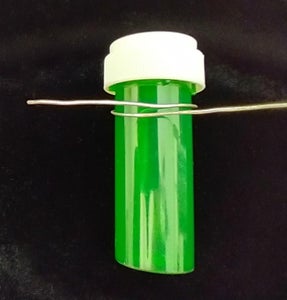

Mark where center is on your 5" frame wire. You can use a small med bottle approx. the size of a quarter to use as a mandrel when forming the frame for the pendant. Wrap the wire around the mandrel & then carefully form a point @ the bottom w/ your tweezer nose pliers as per the photo. The pendant can be reshaped by pulling out the sides of it after forming the point @ the bottom of it & them putting it back on the mandrel to make it more rounded again. Make 2 curls @ the top, using the round nose pliers. When making the curls, make sure you cannot feel the very end of the wire coming out from the round nose pliers. The end should be flush w/ the edge of the pliers & also coming straight out, not bent over to the side.
