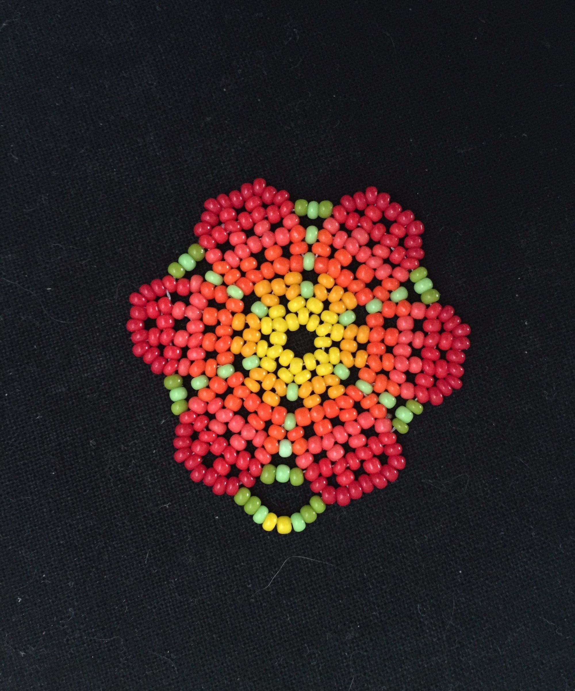

Step 11: Seventh and Last Round \o/
The sequence for this last round is /3-3-3...3-3-3...3-3-3...3-3-3...3-3-3...3-3-3 /
- Take the needle that closed the previous round and thread 3 dark read beads.
- Pass the needle through the second bead of the group below. Look at the picture to see how I did it wrong, ha!
- Thread 3 beads: 1 dark green, 1 light green, 1 dark green; and pass the needle through the middle bead in the next group of 3.
- Thread the next 3 dark red beads; and pass the needle through the second bead of the peak that follows, from the previous round.
- Now, we no longer have a closing peak because we finished this pattern. Instead of putting another 5 beads, you must pass the thread through the 3 beads below your peak.
- Continue until you reach the last three dark red beads. To close the round you must work the thread through the last petal to secure the round. Keep passing the thread through the beads to get away from the last beads you threaded.
Always remember to tight the thread while working, even now that you're almost finished.
Step 12: FInishing One of the Threads, Knotting and Burning It
To assure the thread from coming loose and the piece is lost, pass the thread into many beads as you can and then do a blind knot between two beads.
Cut the thread leaving about 3mm to burn the knot without breaking it. The trick is: the piece goes to the fire, not the fire to the piece.
Now, let's form a small bridge to add a ring, chain, key ring or earring hook to the piece if you want.
Step 13: Bridge to Hang Your Pendant
To do this, we will take the thread that was waiting inactive in the previous round to the bead in the middle of the three dark red and:
- Thread 8 beads of colour you want, in this case I used dark green, light green and yellow as the centre of the flower.
- Pass the needle through the middle bead of the following three dark red ones.
- Now, hide the thread and get it away as much as you want from the latest beads.
- Close with a blind knot between two beads... Leaving 3mm short thread...
- ...and burn the thread to close it.
NICE! We finished this flower! I hope you had fun!
