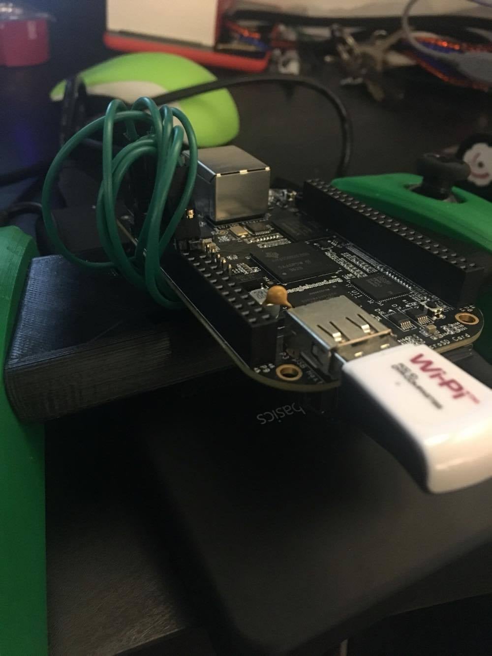

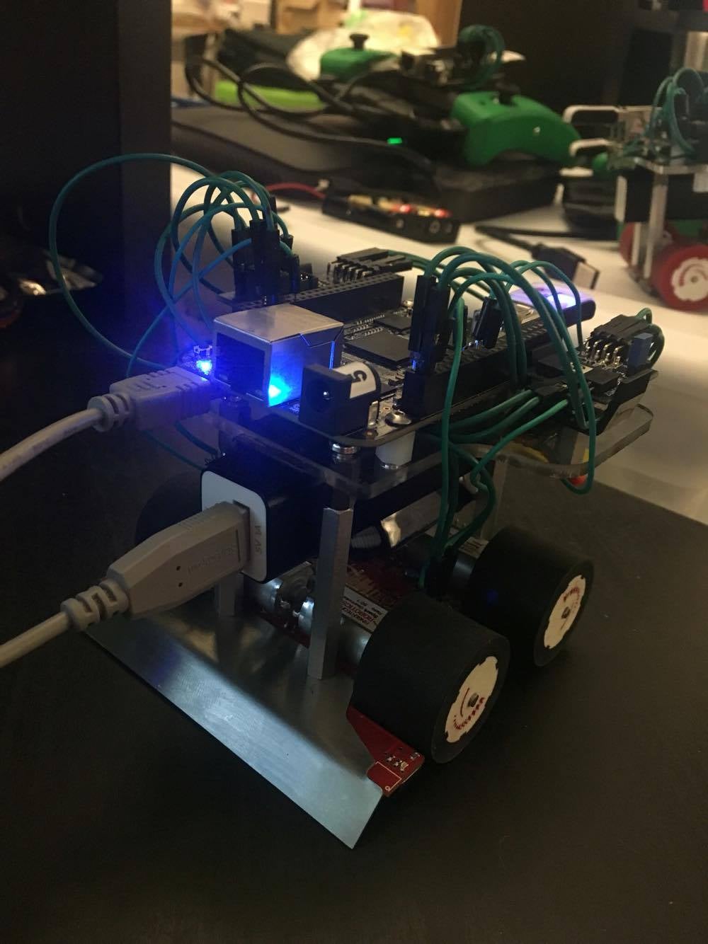

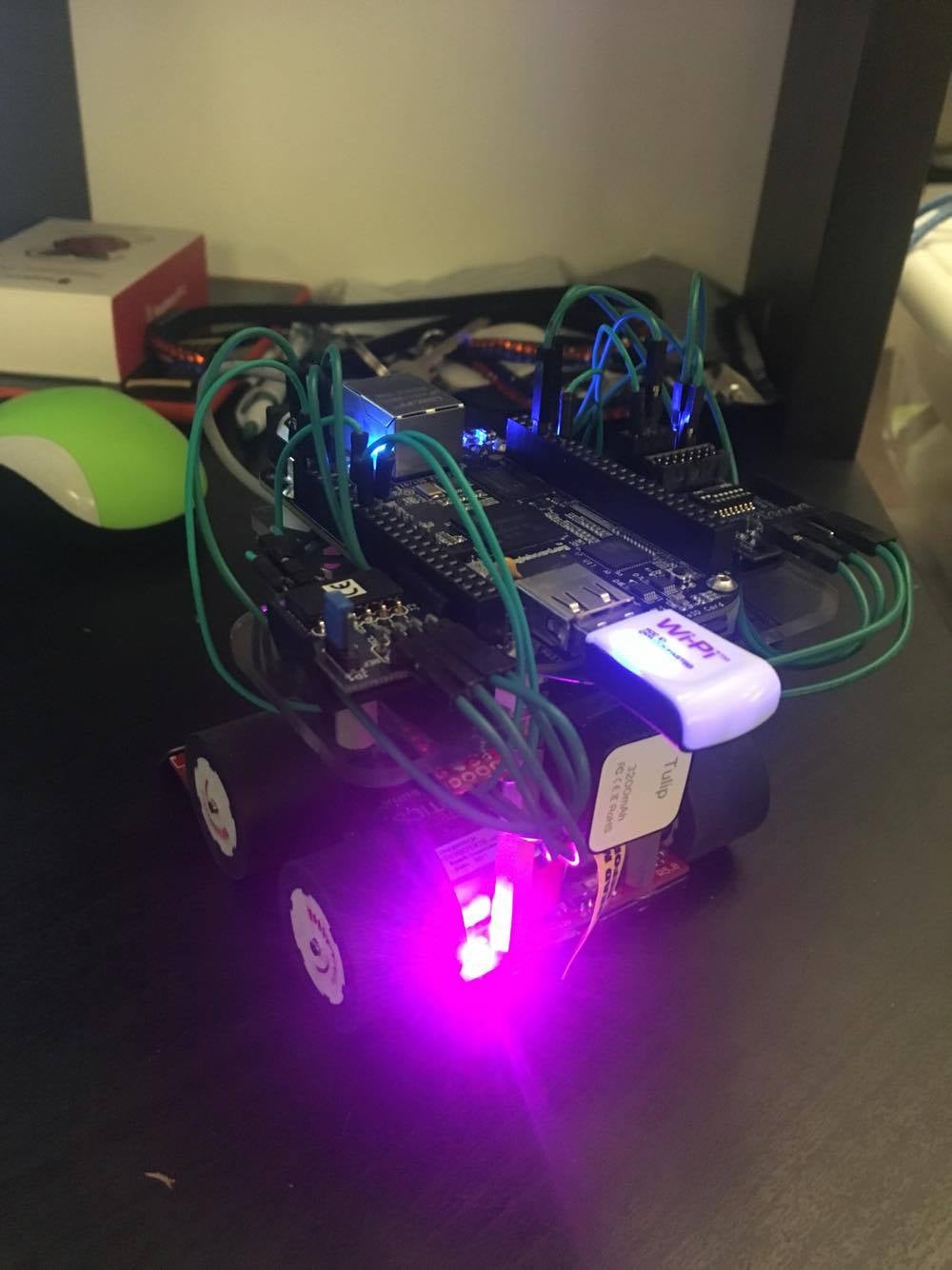

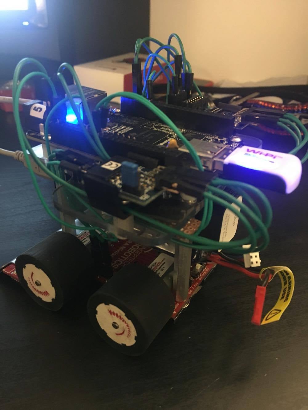

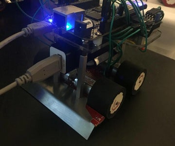

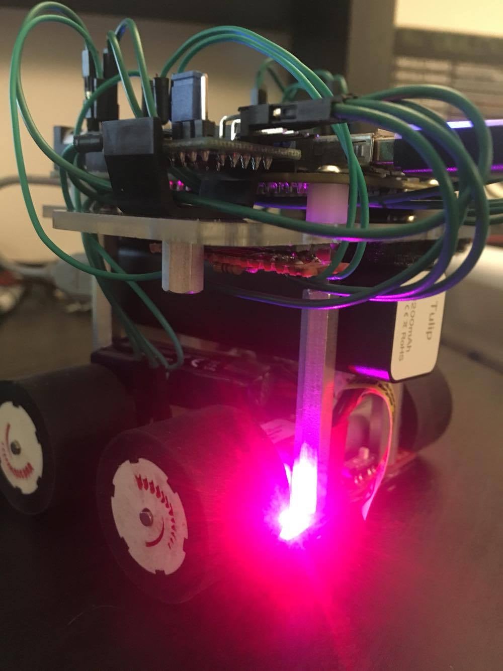

We moved the steel plate to underneath the bot for extra weight. We laser cut a piece of acrylic to fit as a mount for the BeagleBone so it can sit above the bot.
Mounting your BBB to any kind of plate above the board is pretty simple. We added four extra standoffs to allow for a little more space between the BeagleBone and the robot board, and four more on the top side of our acrylic plate to keep the BBB from resting directly on it.
Step 2: Wiring

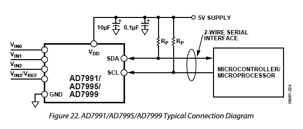

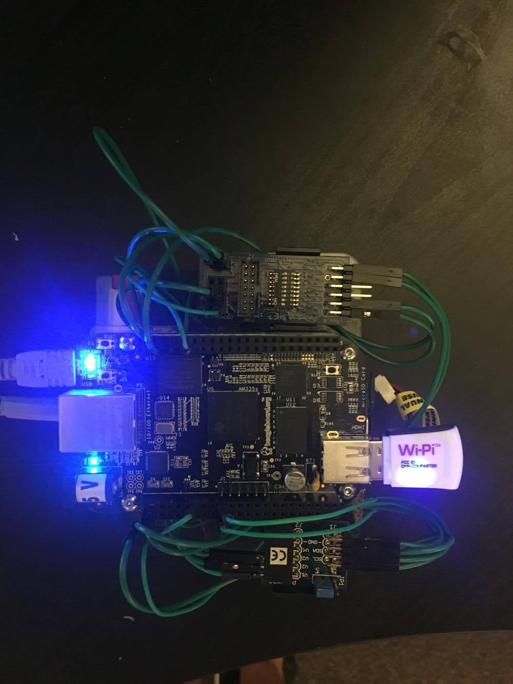

The wiring portion is fairly extensive. In addition to the BeagleBone, we have two Pmods mounted on the bot. We use the Pmod AD2 to convert the analog signals from the sensors on the robot to digital values we can send through the BBB and eventually to LabVIEW.
The sensors on the robot only sense the colors white and black. The analog output reads ~1.7 V when sensing black and ~2.5 V when sensing white. The BeagleBone Black analog inputs have a maximum voltage reading of 1.8 V, so in order to read from the analog inputs on the board we need to step down the voltage. Using two resistors and a simple circuit (pictured above), we ran the voltage across both resistors and the SDA and SCL inputs from the Pmod AD2 across only one resister. This made it possible for us to read the analog inputs from the robot itself without killing our BeagleBone.
The AD2 has four analog inputs but in our case we only need three (because we only have three sensors). On the bot, there are three rows of inputs, each labeled PWM, DIR, W, R, and B (or some variation of these). The input labeled "R" is our analog, sensor input. Wire each analog output on the bot directly to one input on the AD2. The VCC on the connects to 3.3 V on the board.
The Pmod VLSHFT or the logic level shifter is mounted opposite of the AD2. The voltage is supplied by the BBB and goes into the 3.3 V input in Header J1 on the VLSHFT. Pin 1 and 2 in Header J1 go to DIO 7 and DIO 8 on P8 on the BBB.

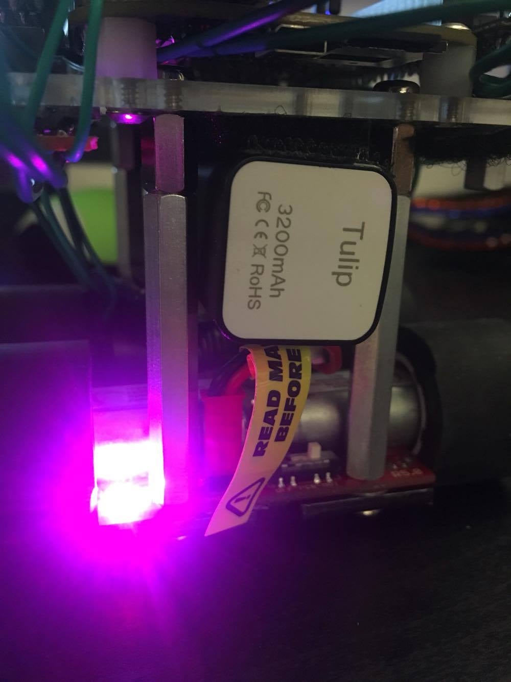

We use LiPo batteries to power the bot itself, and small portable battery packs to power the board and they're mounted below the acrylic plate.

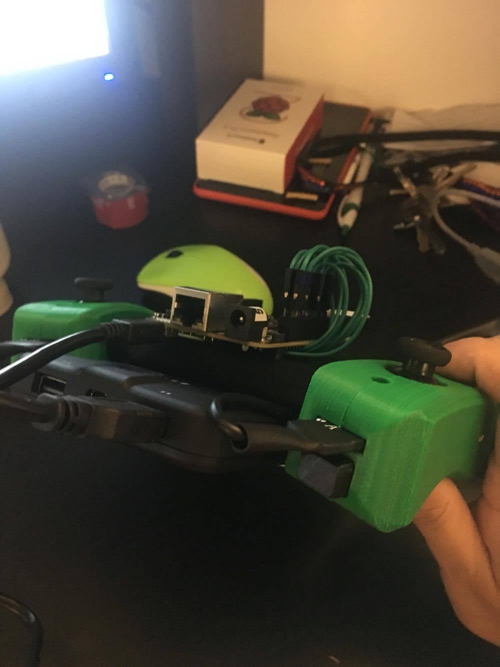

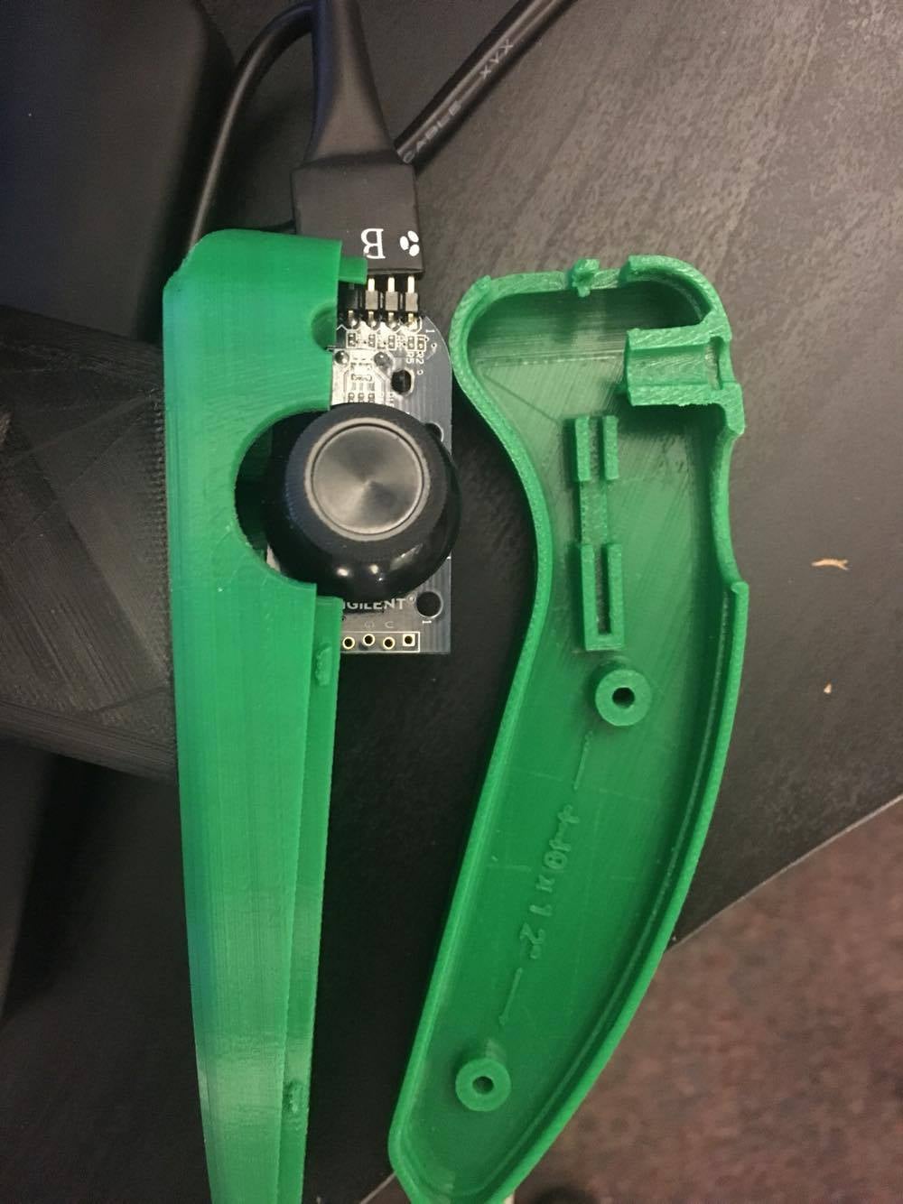

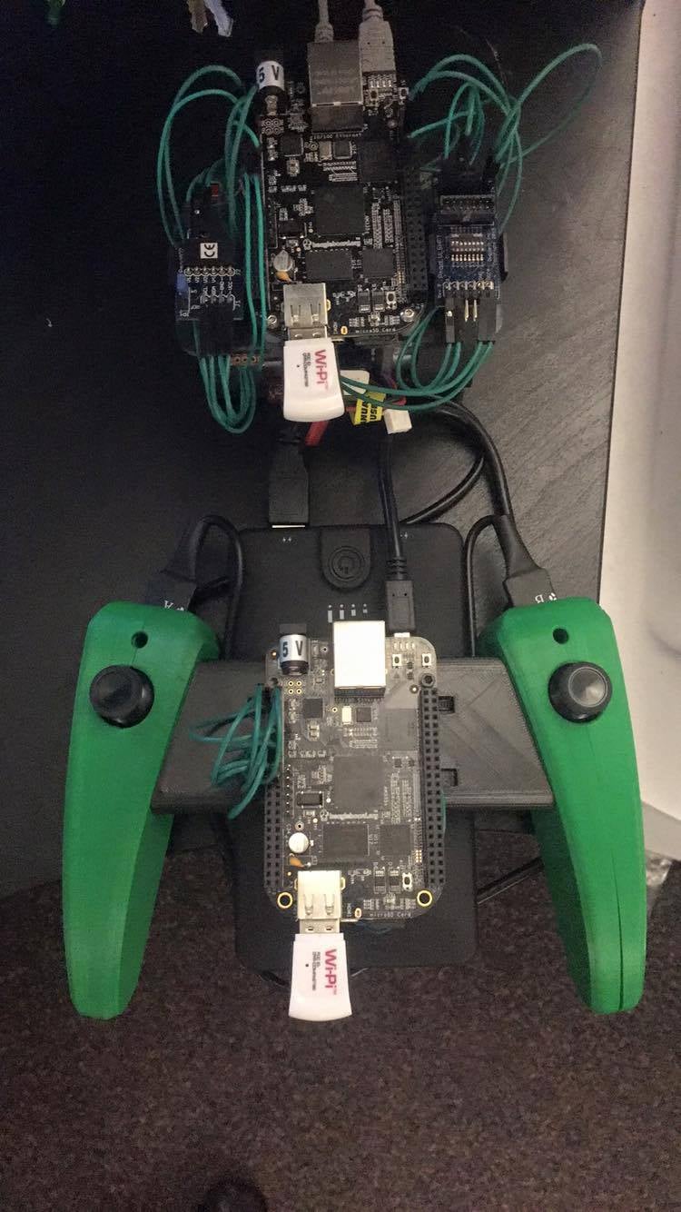

In order to control the bots, we built the controllers from scratch. The handles and midsection are completely 3D printed.
The controller uses two Pmod JTSK 2s, a BeagleBone Black, and a large battery pack that's zip tied to the back. The JSTK 2s are wired in to the BeagleBone Black's digital outputs and are supplied 3.3 V and ground from the board. We use the Wi-Pi to communicate to the BeagleBone on the bot itself.
