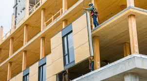

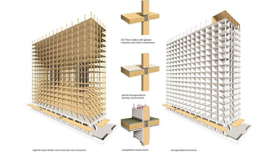

At UBC’s Brock Commons (shown above),one of the best modern examples of mass timber construction, mass timber was used with a simple post-and-slab system. Glulam columns, CLT floors, and steel connectors created a fast, repeatable structure. Most impressive was the use of modular nodes for structure and services, which sped up construction and reduced labor.
Curtain walls, used at Brock Commons, acted as a lightweight, non-load-bearing skin. This kept the structure consistent while allowing flexibility in exterior design and helped meet fire and energy codes.

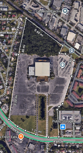

Step 4: Location
The chosen site is a 55-acre former warehouse property in the heart of Riviera Beach, Florida. It sits right next to a major train and bus station, making it one of the most connected spots in the city. The site was recently listed for $7 million, which is relatively low considering its size and central access.
About 15 acres are wooded, offering space for green areas, trails, or even future community farming. The remaining 40 acres are open for development, making it an ideal space for affordable housing, local businesses, and shared infrastructure.
Because of its scale and location, the site has the potential to become a walkable, mixed-use community, where people can live, work, and access transit without needing a car. It's a chance to re-center the city around people, not parking lots.

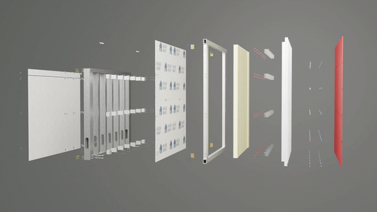

The final facade consists of four major layers, each with a specific function. Closest to the interior is a finish panel, mounted to the primary aluminum frame (more on this below). This panel adds warmth and texture inside while concealing the structure. Behind it, the recycled aluminum frame supports just the facade.
Next is a fiberglass-bonded aluminum sheeting, sealed around all seams and acting as an airtight, watertight barrier to protect the mass timbre structure. This layer also includes a breathable house wrap membrane, modeled as a thin shell. Over this is exterior insulation, offset from the cladding layer to make sure spacing for airflow so that built-up humidity can exit/evaporate.
Finally, the rainscreen cladding is mounted onto the outer secondary. It includes vertical slats and aluminum spacing brackets, allowing drainage and ventilation behind the surface. This outermost skin serves both aesthetic and environmental purposes, protecting the insulation while giving the facade its finished look. The modularity of this layered design makes it easy for owners to customize their building to their preferences.

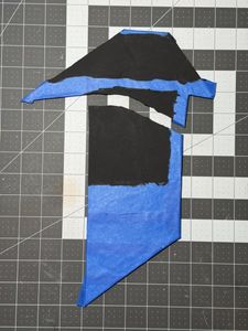

Step 21: Terrain: Concrete

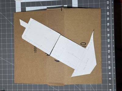

First, I created the "concrete" base of the model. I did this by creating a cardboard mold and then filling it in with plaster of Paris. To make the mold, I outlined the the shape of the concrete on paper, cut out that shape from the cardboard, and lined the void with aluminum paper. I then filled the void with the plaster and smoothed it out to the level of the cardboard. Finally I painted it to my liked to represent the asphalt/concrete. This created a pretty good surface, the only problem was that it cracked when I got it out of the mold :(

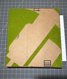

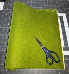

Step 22: Terrain: Grass Base

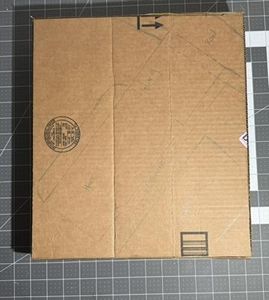

I then created the base of the dioramma by using a cardboard box. I cut out the diorama grass to size and glued it to the surface using hot glue.

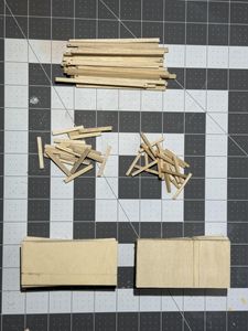

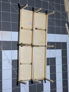

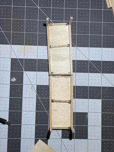

Step 23: Building: Frame

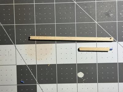

Next, I moved on to making the frame of the house by cutting out the balsa wood sheets and sticks. This was very straightforwad, just a bit repetative.

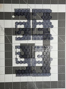

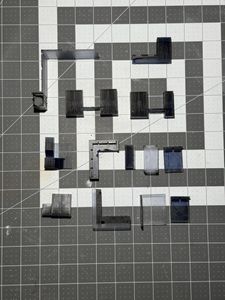

Step 24: Building: Interior

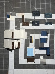

After making the frame, I then 3D printed simplified versions of the interior part of the house. After post-processting, I used regular arcylic paint to paint all parts

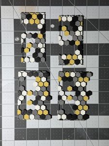

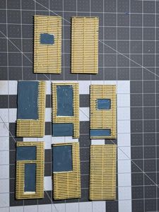

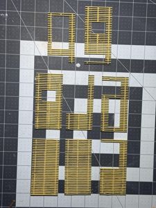

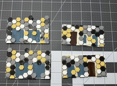

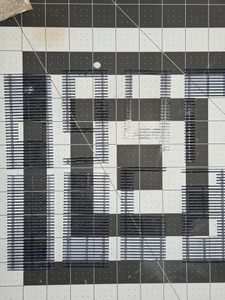

Step 25: Building: Facades
I did the same thing with the facades, only this time I made sure to apply multiple layers of primer because these parts were much thinner than the interior parts.

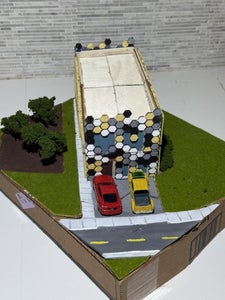

Step 26: Complete Prototype
Et Viola! Hopefully it lives up to the BearGrass name!
