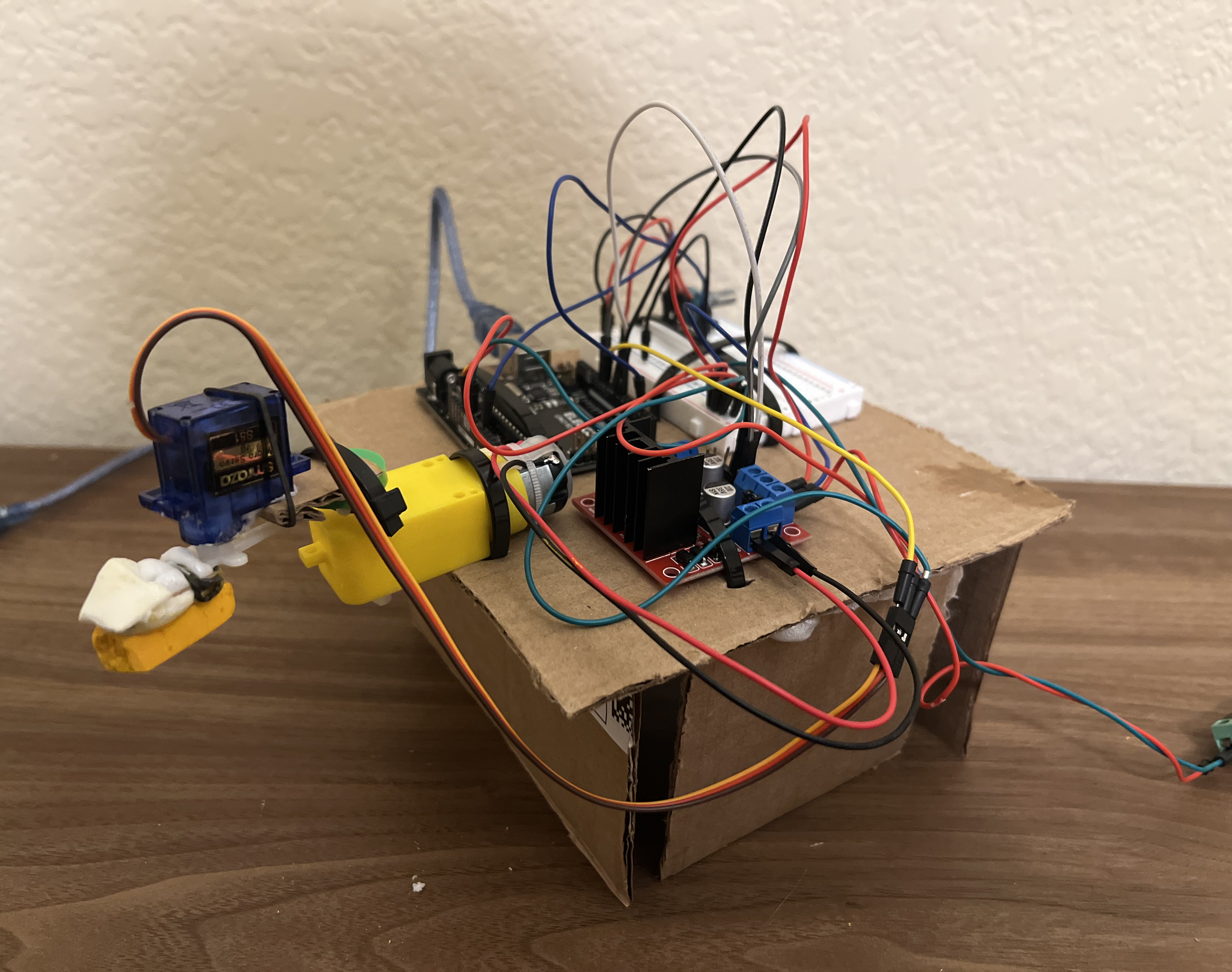

Step 4: Structure
To make use of the hardware we built thus far, I used cardboard and various items to build out the beat making machine.
I started by securing the Arduino, MOSFET module, and breadboard to a large sheet of cardboard. I then glued the servo motor to the sheet with its axle facing up.
Next, I glued the solenoid to a thin piece of cardboard that I attached perpendicularly to the axle. With this, the servo motor now controlled the positioning of the solenoid.
Finally, I attached various items such as a magnet and a keychain around the servo motor. The goal is to write a script such that the servo motor spins around, allowing the beating solenoid to make different sounds against these different items.
