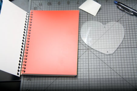

First go make your basic template in photoshop. I found some heart brushes online and found a picture to fit. I then used the transform tool to create two different sized hearts. I printed some test pages until I found a size I was happy with. The larger heart is 5.5" I decided to go with a stylized heart and cut off the tip at the bottom so that it would stand up well.

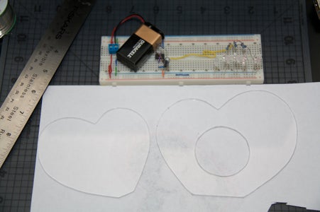

Step 3: Cut Out Frame
I used a nice bench grinder because I found a friend who could lend me his. If you dont have one you could use a dremel as I was planning on doing. It just goes much easier with the right tools. You could even get the whole thing laser cut if you wanted. But where is the fun in that? I used my printed out templates and taped them to the front of the plexiglass. I then used a sharp exacto knife to trace out the heart shape onto the plexi. This created a guide line for me to follow when I was grinding. I also cut a circle out of the middle of the larger heart for the LEDs to go.

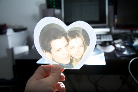

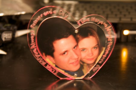

Now it was time to etch the larger heart so that it would show the text. This is where the laser cutter/engraver would have come in handy. I had a dremel with an engraving bit and it did a decent job. I would recomend trying your skills on a practice piece. Go slow and take your time. You can always remove more material you cant put it back on!
Lets first talk about how I made the template. I took my same photoshop file and wanted text to wrap around the curvy heart shape. This is very simple once you know how to do it. Use the pen tool and draw one side at a time from the middle top to middle bottom on separate layers. Dont worry if you have shaky hands or you mess up you can use the other pen tools to fix your curves and straiten everything out. Once you have your two curves drawn click on the Text tool and hover over one of the lines. You will see the icon change to having a line drawn through it. When you click you will now be able to type text on that path you just drew. Play with font sizes and styles to get everything the way you want it. Unless you are awesome with a dremel then I would suggest that you use as large and simple of a font as you can because many of the smaller details will not show up well.
Once you are happy with how the image looks flip it horizontally then print it out. I printed mine onto sticker paper but you can use regular paper and some scotch tape if you want. Sticker paper is very useful for projects like this so it is worth a few bucks to have some on hand. In the second image you can see the sticker paper stuck to the back side of the plexiglass with the picture taken with the camera flashing from behind to illuminate it. The reason for the flipping of the image is so that we can etch on the back side where imperfections will not show as much and the front side will look glossy and smooth.
The final image shows after the etching with the heart being edge lit by my flash for purposes of taking the picture.

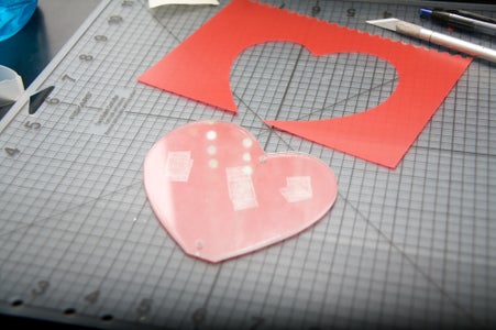

Step 5: Finish Picture

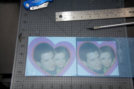

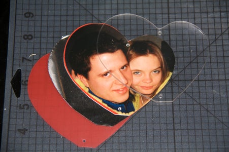

Now that most of the hard work is done it is time to finish up the picture so that we can snap it into place when the rest of the frame is done. I picked up this ~$3 notebook from a local drug store because it had a thin red semi transparent cover on it. If you have an old notebook you can use that as well. This will make up the backing for the picture so that it looks nice from behind and the sides.
Take your smaller heart and use it as a template to cut out the right shape using a sharp exacto blade. I cant stress enough how helpful it is to use new exacto blades for this kind of thing. Once it is cut out you can trim the edges or any imperfections by running the exacto blade along the edge of the plexiglass until both pieces are identical. You may also note that I drilled holes in the smaller heart. This is to join the two hearts together later with some small bolts and nuts. Make sure to cut holes in the plastic to match.
I thought the red plastic would be enough to keep a red ring of LEDs from leaking through the picture but it was not. I then concluded that tinfoil placed between the picture and red plastic would block all light for sure as well as not short out the LEDs. I used 3M #77 spray glue (another favorite product of mine) to glue the three pieces together. In the last picture you can see all three assembeled with the small bolts inserted. Use the exacto knife where needed to trim everything up. I used windex to remove all fingerprints etc from the plexi.

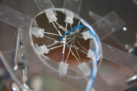

I then used the hole I had cut in the larger heart and some tape to create a jig of sorts. I first soldered two LEDs at a time together by the negative (shorter) legs and bent the (longer) positive legs up at about 45deg. I taped 4 pairs of LEDs at equal 45 degree angles from each other and then soldered the now touching negative legs together. Then I bent down the positive leads so they were all touching. I took some cat5 networking wire to use for a lead. The negative (blue) is connected to all the negative LEDs. The positive wire is wrapped around all of the positive leads binding them together then soldered.

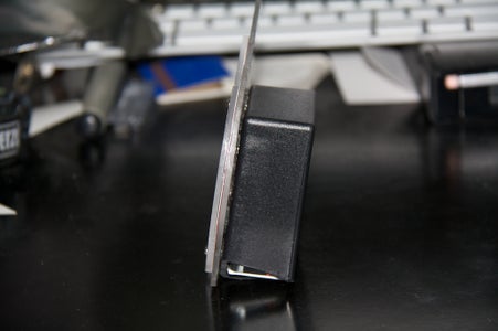

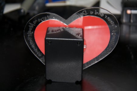

I took a small project box and trimmed the corners to fit the shape of the heart so that it would not show near the bottom. I used hot glue to attach it to the larger heart. Note I attached the BOTTOM of the box to the heart so that I could later have access to the screws that hold the lid on the back. After attaching I cut a hole gradually until the LED assembly that I soldered together fit in nice and flush. I then used a small blob of hot glue next to each led to hold it in place.

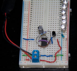

I will include the schematic again in this step for reference but once you have the parts it should take all of 5 minutes to put this together on a bread board. The beauty of this circuit is that it is all analog (meaning no code or processor to fail or program) and it requires a very minimum number of parts you should be able to find at radio shack or a local electronics store. Let me take a minute to explain the circuit.
The 555 timer circuit is one of the best known IC's around. Apply voltage and it will produce a pulse which you can then use to do all kinds of things like build a clock etc. In this case I wanted to build a circuit that would slowly increase voltage to an LED then slowly decrease voltage again. The way to do this is to start with basic PWM. Pulse Width Modulation can be found all over online and here on instructables. Basically instead of changing the power sent to the LED I am sending it manny quick pulses of power every second. The more pulses I send per second the more power the LED receives. The fewer pulses I send the dimmer it becomes. We see this as bright and dim but in reality the LED is flashing on and off much quicker than our eyes can detect.
The 100k resistor and 100uF capacitor are the main components which control the rate of fading in and out. The capacitor serves as a reservoir so that when the power is cut to the led it slowly fades out instead of a quick flash on and off. The resistor controls how fast the circuit is powered up again and therefore controls how fast it fades on. I have built this exact circuit three different times with separate components and used variable resistors and different capacitors and many extra unnecessary parts. This circuit will produce the exact effect shown in the videos and should cost less than $5 for all the parts needed.
The Transistor (2N2222) is the smaller TO-92 package size. This acts as an amplifier/switch to control the LEDs. You cant connect the LEDs directly to the output of the 555 timer (pin 7) because the signal is too weak to power them. The transistor acts as both an amplifier and an electronic switch. It connects to the power source with the Collector leg, the output with the Base leg, and the LEDs with the Emitter leg. Whenever it receives a signal on the Base leg (from the output of the 555 timer) it applies power from the 9v power source directly to the LEDs through the 500ohm resistor. Wont this fry my LEDs though? It would if you connected them directly to the battery. Since we have built a PWM circuit they are all receiving 9v for a very short amount of time. So short in fact that measuring the voltage with a volt meter shows 1.3-1.6v which is perfect for almost all LEDs.
I connected all of my LEDs in parallel meaning that all of the positive leads are connected and all of the negative leads are connected. If one were to burn out the others would keep going. Also I only need one resistor for all of them and it makes soldering them together much easier.
I used a small piece of prototyping board that was ~1$ and cut it to fit in the box. You could solder everything together if you wanted or make a PCB but this worked well for me. I used double sided sticky foam tape to tape the circuit board inside the project box. The wires from the LED array (green/white) are soldered directly into the board. The negitive 9v battery connector is also connected directly to the board. The positive lead however is connected through a switch on its way to the board.
