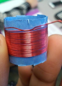

Step 4: Make Your Coil
Grab your wire, and make the 30-coil wire using your post-it covered glue stick so you are able to take the coil off of the glue stick. Make sure the coils are tight and does not resemble a slinky (loose, curly wire). Tape two sides of the coil so the coil stays tight. Do the same for your second coil.
The whole point of the headphones is so that we can hear music from an audio source. No electric current, no headphone. For our prototype headphone, we choose to test 10, 30, and 50-coil wire. The coil that produced the best quality of sound was the 30-coil wire. That is the reason we chose 30-coil wire for our final design.
Step 5: Repeat Step 3 for Second Coil
