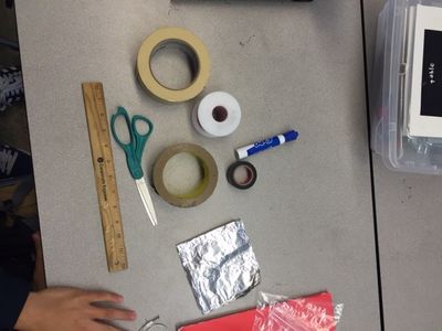

Step 5: Assembling Prototype
Once you are done wrapping the coil wire,then you get two clear plastic cups, two neodymium magnets, grab the black electric tape and you begin to start assembling your speakers. You first put the magnet on top. Next put the coils over the magnet. Also tape enough electric tape for it to be stable. Lastly you make sure you leave to of the one inch ends sticking out.

Step 9: Materials List.
1. Red Copper wire 10 in each
2. Neodymium magnets
3. White Board Marker ( any kind of marker is fine and or glue stick).
4. 12 in wooden ruler.
5. Black electric Tape.
6. Masking Tape' (
7. Regular Clear Office Tape.
8. Clear Plastic Cups.
9. Tin foil
10. Aux cable
