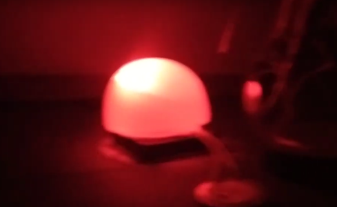

After researching, I found that software PWM could be implemented on the ATtiny85, allowing for smooth color mixing and gradient changes. The result was beautiful, but I wanted to add more features, such as changing to a specific color upon receiving an input or functioning as an RGB mood lamp. A piezo sensor seemed like a handy addition to enable color changes by clapping.

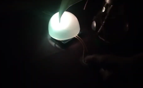

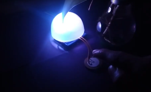

Step 3: Troubleshooting the Piezo Sensor
Initially, the piezo sensor didn't work as expected. The colors wouldn't change due to a small bug in the code. After debugging and making necessary adjustments, the sensor functioned correctly.

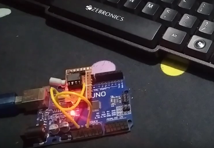

Step 4: Programming the ATtiny85

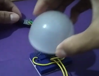

I used an Arduino as an ISP programmer to upload the code to the ATtiny85. If you're unfamiliar with this process, check out this video tutorial for guidance. Once programmed, place the ATtiny85 back into the circuit, connect a 12-volt adapter, and enjoy your RGB Dome lamp. The connections are made as shown in the schematic. The diffuser I am using here is from an old bulb.
