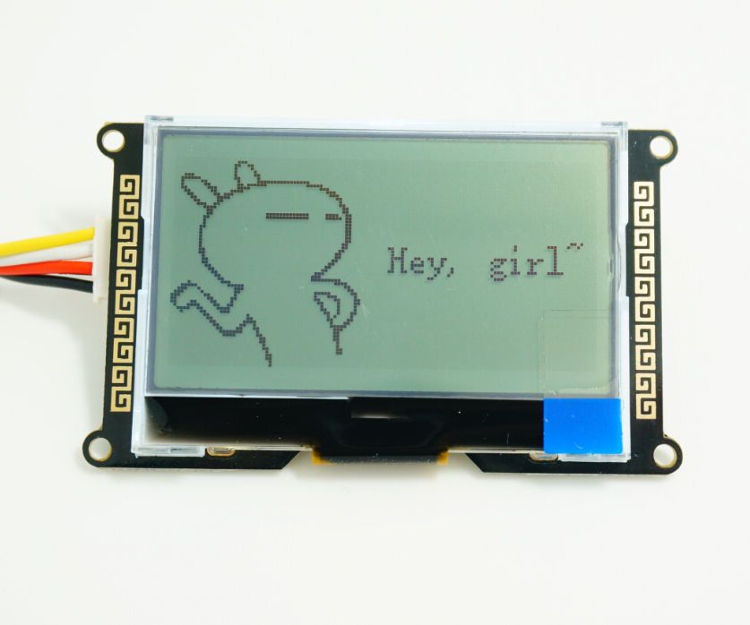

Use I2C_LCD to make a beautiful and practical clock with calendar.
I2C_LCD can display bitmap, graphic and character, you can make beautiful UI for your project with I2C_LCD.

Connect the I2C_LCD and Grove-RTC to your Arduino board, here we use Seeeduino Lotus.
I2C_LCD and Grove-RTC are I2C interface module, so we connect them to the I2C bus.
