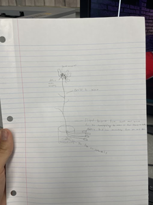

To start the project, we spent the first few days outlining a design for the rose. Starting with brainstorming ideas individually, each member of the team came up with 2-3 ideas. At the end of the session, we combined certain aspects of our ideas to create our final design.
The main focus of the brainstorming session was figuring out what mechanism to use to make the petals drop. We had numerous ideas, some feasible like the 2D rose (petals would be mounted on a board or screen oriented toward the audience), others silly (the team will fondly remember the "airsoft gun shooting petals from the back of the auditorium" design). We eventually came across a website made by Steve Murch, containing detailed steps for how to build a prop rose. His instructions would guide the build direction of our rose from that point onwards.
Murch's original design employed the use of magnets with servos, but he also made a second version that used air pumps. From his designs, we proposed 3 options: electromagnets, servos with spring-loaded magnets, or air pumps. Originally, we decided to pursue using electromagnets to drop the petals, but quickly ran into a problem; the electromagnets would need to be constantly active for the petals to stay on. The electromagnets we researched only had the ability to stay powered a minute or two before they overheated or failed. As a result, we decided to abandon the electromagnet idea. The second option was to use normal magnets instead of electromagnets. The magnets would be attached to strings pulled by servos located in the base of the flower, and, upon the servos pulling the strings, would be pulled inward and unattached from a metal point in the petals, causing the petals to fall. This idea was more power-friendly compared to the design that used electromagnets, since servos only require power at point intervals rather than constantly. The third option was to use air pumps to push the petals outward. This design would have fewer moving parts, thus lowering complexity. However, we eventually settled on the second design, as it seemed to be the most straightforward with the resources we had available.
Once we chose a mechanism, we thought up several base designs, since the flower would have to sit upon a supporting structure. The two main options were short and wide or tall and thin. Eventually we decided on a short and wide base, made to emulate the appearance of a tree stump, as we thought it would give the rose a very fairytale-like presence. Additionally, a short and wide base would give more stability than a tall and thin base, which would desperately be needed on the very active stage.
During the brainstorming period, we also created a Gantt chart, which is a chart that allows engineers to schedule tasks and deadlines for team members to meet. To be honest, I didn't really see the point of the chart at the time, but now that I'm in the position of trying to document and order the events of creating the rose, I'm extremely glad that we made one. I've attached both the prototype and final Gantt charts below if anyone is interested.

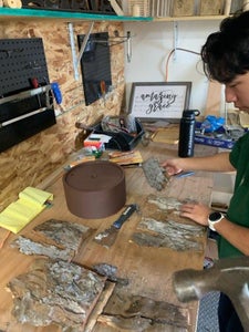

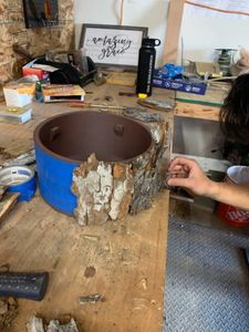

Adding tree bark to the exterior would've remained an idea on the drawing board were it not for my school's woodshop/skilled trades class that helped us with this step; special thanks to Cadence Monfore for, upon being asked, literally walking out to the back with an axe and chopping a log for us to use.
The following was written by co-project lead Austin Drown, as he was the main team member working on this step in conjunction with woodshop:

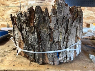

For the bark, I used a mixture of wood glue and epoxy to make it stick. I had to line the outside of the base with blue painters tape because the 3d filament plastic wasn't good at holding the epoxy on. Cade helped me with breaking up the wood bark; for the rest of the gluing it was basically a puzzle to figure out where each piece looked best.
After attaching the wood bark, zip ties were used to hold the bark in place as the glue dried.

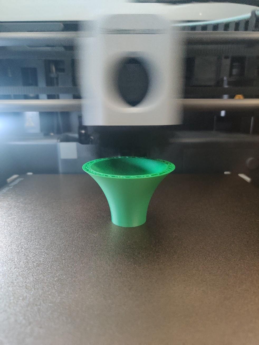

Before moving on to final stage preparations, now would be a good time to go in-depth about how we utilized 3D modeling to create the rose. CAD, or computer-aided design, greatly helped us not only to print the final parts but to also visualize and test different ideas before making them reality. About 80% of the structural elements of this project, including the base, stem, and bulb, were 3D printed, after first being modeled in Fusion 360. All final Fusion files are attached below, although our prototype models are not included because I no longer have access to them (oops). Most of the models were designed by our in-house modeler, Scott Aznoff, although Austin and I also modeled a fair bit.
For the base, we had the opportunity to use an FLSun V400 3D printer, which has a 12 inch diameter circular build plate, so we took advantage of this and scaled our 3D model accordingly. The resulting base is 11 inches in diameter, with a ~10 inch lid. Unfortunately, most 3D printers are not able to print an object of that size, so it's recommended to scale the base down to 9-10 inches instead. If others were to build their own rose with our files, when scaling down the base, make sure to keep the hole at the center of the lid the same size in order to allow the stem to fit. The glass dome needs to fit the base as well, so plan accordingly when choosing a diameter.
As for the lid of the base, I've made a change to the 3D model that will make a later step easier; when we were attempting to add lights to the rose, we realized that we needed a hole in the lid to allow the wire to pass through. This forced us to go through the arduous task of drilling a hole into plastic. A hole has been inserted at the edge of the lid to eliminate this step.
3D printer settings will vary, but for the majority of printed parts we used a 0.4 mm nozzle.
