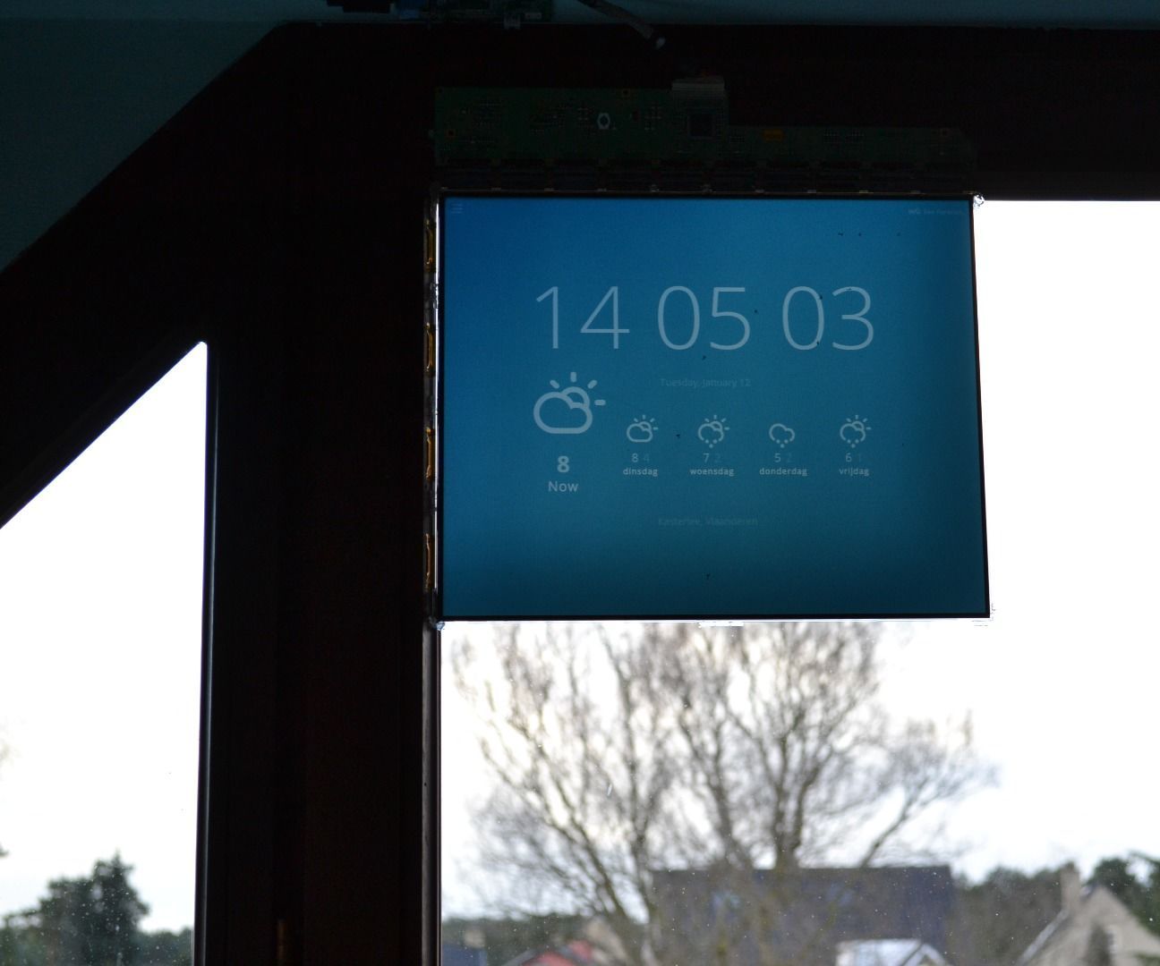

The concept is quite simple : mount a monitor on a bedside table and display the weather and time on it.
You need :
- a old (low-end) netbook (Almost any laptop or desktop will work)
- a computer monitor
- a VGA cable
- a power(or reset) switch from a desktop pc

Normally if you open a new tab Momentum should show up (see image).
Follow the on-screen instructions and set it up as you like.
When you are ready you should see something like this (see last image).

- Set auto refresh to 15 minutes or more to make sure it refresh the weather at least 2 times per hour (see image)
- Press F11 to enter fullscreen mode
- Press the wakeup switch to test if it goes to standby
- Press it again if it is off, it should turn on in max 10 seconds
- Voila, your wakeup screen is ready to use
- Have a gentle wakeup experience !
