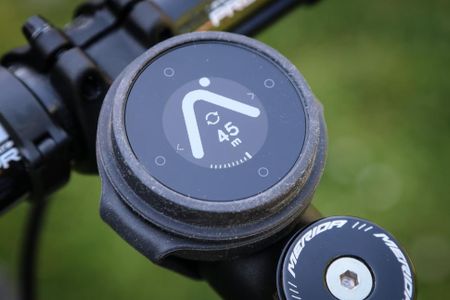

The Beeline Velo is a simple and easy to use route-following device that's quick to set up and great if you're doing point-to-point rides and you're not sure of the way. Before the recent software updates there was an OFF funcion-but for some reason this function has been removed by the developer and therefore it is not available any more.
I saw this (https://www.thetawelle.de/?p=5873) project, but found it way too functional plus its destroying the neat, minimalist design of this beautiful device. Here comes my solution.

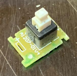

Step 1: Getting a Small Toggle Switch
Fortunately I had a broken Wilkinson "pocket-trimmer" which has a desired toggle on-off switch. Actually here comes half of my idea. You can try to scavange these switch from broken electric toothbrushes etc as well. Or buy one. Please note: the space inside is fierce!
