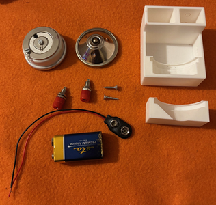

We need:
1 pcs microphone (extracted from old phone)
1 pcs speaker (extracted from old phone)
1 pcs 9V battery
1 pcs connector for 9V battery (can also be extracted from the old battery)
2 pairs banana + socket connector
2 pcs screws 2.5 x 12
and some wires (extracted from UTP cable)

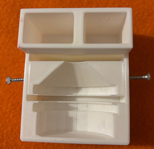

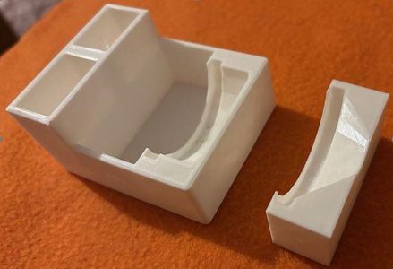

Step 1: Morse BOX - 3D Print
Print both files on 3D printer. Rafts:No; Supports:No; Resolution: 0.2mm, Infill: 20%.

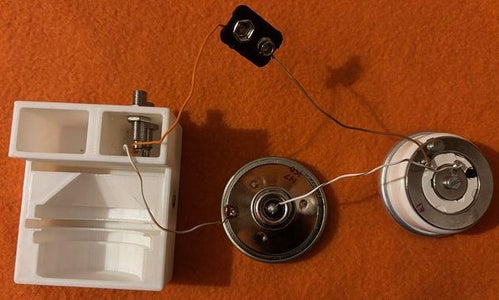

Step 2: Electrical Wiring
All things are in serial connection: Banana1 - Battery - MIC - Speaker - Banana2

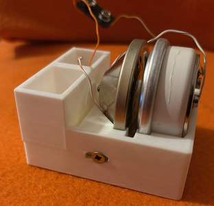

Step 3: Mechanical Assembly
Place the "carriage" in the "box" and secure it with two screws. You can try what happens when you move the microphone further or closer to the speaker.

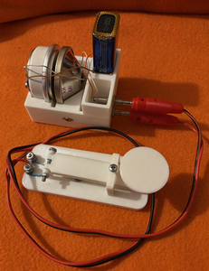

Step 4: Final
Connect telegraphic key and start to learn Morse code.
