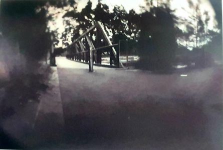

Here's a gallery of the positive images from photos I have taken with beer can pinhole cameras over the past few months. When taken they are a negative. My 'work-flow' is:
1. Take the photo with the beer can pinhole camera fixed to a tripod (secured using blue masking tape). A light measurer app on my phone assists in guessing exposure times.
2. Develop and fix the image using 'home made' developer of water, washing soda, vitamin C and coffee. I use a new mixture each time I develop a batch of photos. Fix the photo for 36 hour in salt water.
3. Take a photo of this image with my phone. Crop the image and adjust if required. Convert into a positive image using the 'Negative image' app. Mirror image it to covert back to correct orientation. It's surprising how occassionaly a poor negative image can be made viewable with a little editing.
4. Save the positive image. Print out the positive photo at a self-service digital photo printing store.
