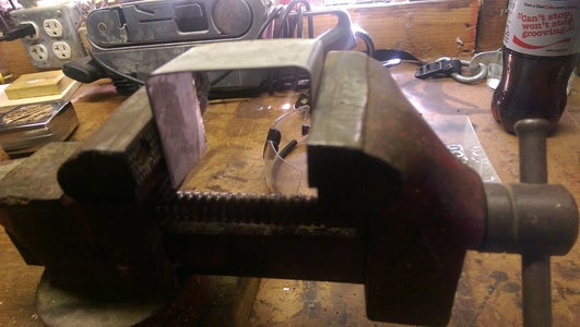

The grills inside will be held up with 3 legs. And the legs will be bolted in, through the walls of the lower unit. I measured so that the upper bolt on each leg would be placed where I could also install little tabs on the outside of the lower part, so the upper didn't get lopsided. I made the tabs from mild steel angle iron, punched, drilled, ground smooth, sanded, and painted with high-temp barbecue paint.

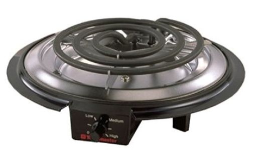

I already had a 750 watt Toastmaster electric burner from my previous experiments with the flower pot smoker. If you need one, Amazon Prime has them for about $22 US. One screw holds the entire thing together.
One of the disadvantages to the flower pot smoker was that the temperature control was buried deep inside the smoker. I decided to relocate the control pot off of the hot plate and to the outside of the keg. It all came apart easily. I then drilled the outside for the control knob and reapplied the label with spray adhesive. I drilled a hole in the bottom of the keg for a new power cord, and sized so that I could put a grommet in the hole before the cord so the metal wasn't touching the insulation. Next I fished the cord up through the plate, sent one wire over to the control and back, and wrapped everything going inside the hot plate with fiberglass. I then drilled out the plastic bottom of the hot plate for a long 1/4" bolt that would go through the drip pan, base, and keg to not only hold everything together again but also fix it to the inside of the keg.Photo
