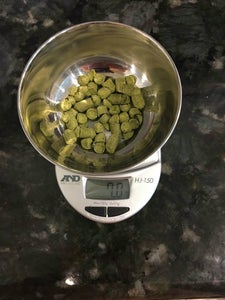

At this point, it's advisable to go ahead and measure out your hops into clean, sanitized bowls. If you bought a kit with pre-measured hops, you can either weight them out or just eyeball it. Otherwise a small kitchen scale comes in handy here.
Divide the Tettnanger hops in half, and the Hallertau into thirds.
