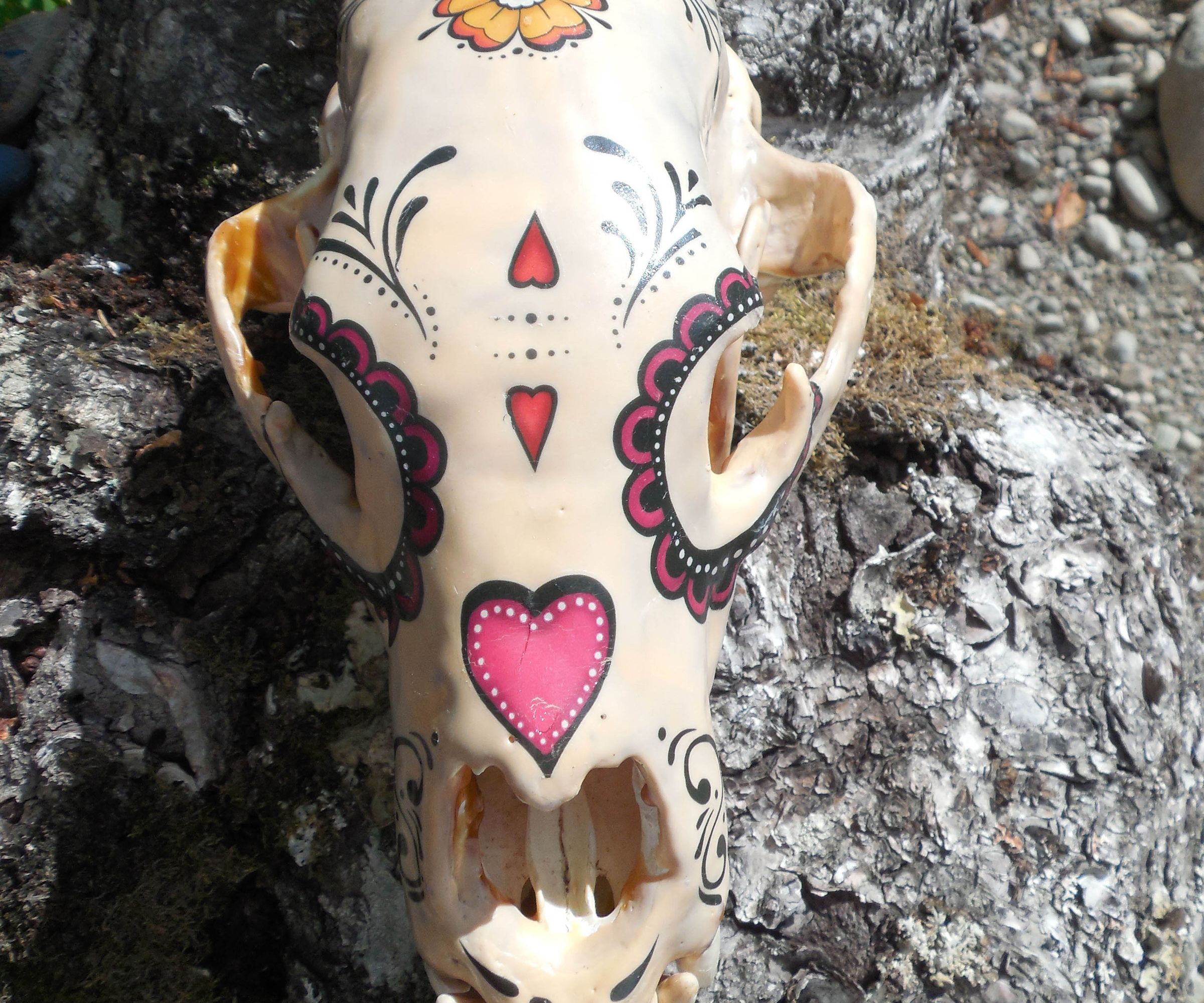

Encaustic wax art is pure organic beeswax and dammar resin. The pigments are high quality cakes of wax made with natural ingredients like oil paints. The word Encaustic is Greek which simply means to burn in. The wax is melted on a hot pallet and applied to the substrate hot, it cools instantly, then each layer is then reheated and the next layer is applied. This fuses the layers together and gives it integrity.
Encaustic painting is like nothing else it has depth and luminosity that other mediums cannot achieve. Because the wax is malleable there are infinite possibilities. Each painting is a one-of-a-kind work of art.
Encaustic paintings require simple care: The melting temperature of wax is 160 degrees F so do not leave it in a car in the summertime. In extremely cold temperatures the painting becomes vulnerable to cracking so keep it inside and if the edges are not protected the paint can chip off. If that happens, I will gladly repair the painting for you. One more thing; for awhile the painting will get a cloudy appearance called a bloom: Simply take a soft cloth and buff the surface of your painting and it will glow.
