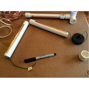

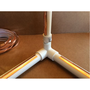

    Cut the PVC pipe to nine inch lengths. Fit the caps on one end of each PVC pipe.
    Step 3:
    Screw the PVC male adapter into the the side insert elbow.
    Add the three PVC pipes as shown.

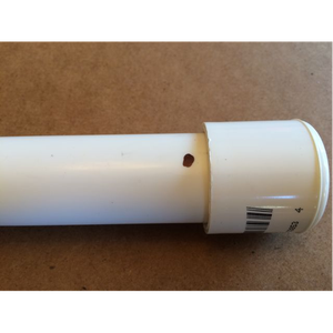

    Use the permanent pen to make a mark on both 3/4” PVC pipes near the caps. Make a mark on the 1/2” PVC pipe near the adapter. Make a mark in the center of the 1/2” PVC cap. Make a mark in the center of the PVC cap of the pipe on the left, if you are looking at the controller straight on.
    Step 5:
    Use a drill to drill a pair of small holes parallel to one another in the ends of the pipes.
    Step 6:
    Using a series of increasingly larger drill bits, work up to a 1/4” hole in the 3/4” inch PVC cap. Work up to a 1/2” hole in the 1/2” cap.

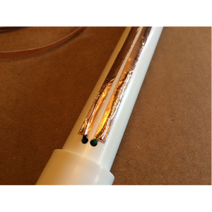

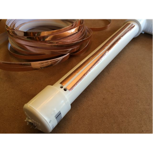

    Use copper tape with conductive adhesive to build a pair of parallel strips along the length of the three PVC pipes. Make sure the strips do not touch and form a short circuit.

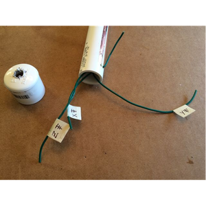

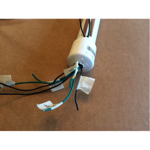

    Start by wiring the Earth, or ground, copper tape strips. I used green wire for these strips. Feed the wire through one of the holes you drilled. For consistency, use the hole in the same position on the other two PVC pipes.
    Step 9:

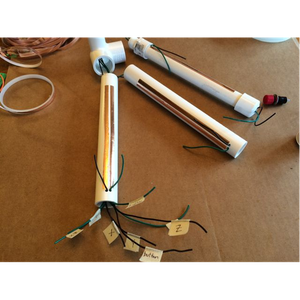

    Label each wire with a small piece of masking tape and the corresponding PVC pipe. The vertical pipe is Z, the pipe on the left is X, and the pipe on the right is Y.

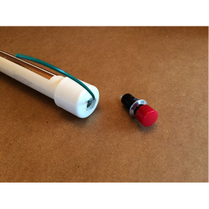

    Route an extra ground wire through the hole in the 1/2” PVC cap on the vertical pipe. This wire will be used to connect the momentary switch.

    Wire the other pads with a different color wire. Label each wire with masking tape and the corresponding X, Y, or Z axis.

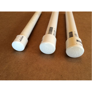

    Carefully route the wires through the 3/4” PVC cap and secure the cap to the end of the PVC pipe.
    Step 13:
    Use a small zip tie to bundle and secure the wires at the hole in the PVC cap.

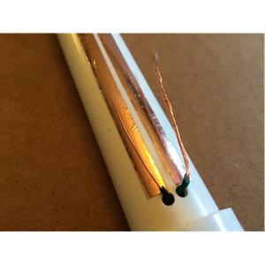

    Strip the insulation from the wires where they overlap the copper tape.
    Step 15:
    Put on your safety glasses. Use a soldering iron and solder to carefully solder the wire to the copper tape with conductive adhesive. Cover each soldered wire with another piece of copper tape with conductive adhesive.

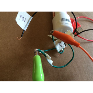

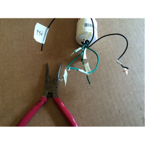

    Carefully strip 1/2” of insulation from the ends of the wire coming out from the PVC cap. Tin the ends of the wire with solder if needed. Use the needle nose pliers to gently bend the wires into loops to make them easier to clip onto with alligator clips.
    Step 17:
    Connect alligator clips to the ground wires. If you pair the wires, you can connect all four to the Makey Makey using two alligator clips.
