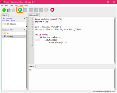

Step 2: LED Control With Button
(1) The 38th pin on your Pico's pin diagram is "GND," the ground pin, while the 36th pin is the "3V3 (OUT)" pin. These two pins will appear frequently in your projects. To begin, construct the circuit on the breadboard as shown in the picture above.

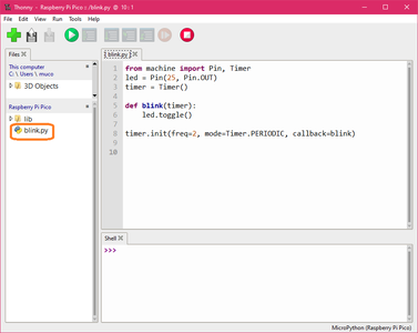

(2) Then open your Thonny IDE and make changes to the "blink" code you created in the previous project. Double-click the "blink.py" file on the left side of Thonny IDE to open it. You'll be able to see the codes you wrote in the prior project. Now you'll fully remove these codes and replace them with fresh ones.
(3) You specified the hardware of Pi-co using the code "from machine import Pin" as in the previous project and included the "time" library when you looked at the code below.
You designated the 15 numbered pin as the pin you linked to the LED using the code "led = Pin (15, Pin.OUT)". The code "button = Pin (14, Pin.IN, Pin.PULL DOWN)" specifies the pin number 14 as the input pin to which the button is connected.
After that, you made a "while loop." It will alter the state of the led in this cycle based on the value read from the button. If you push the button once when the LED is off, it will turn on; if you press the button while the LED is on, it will turn off.
The LED will flash and flash at half-second intervals when you push and hold the button with the code "time.sleep (0.5)".
import time
led = Pin(15, Pin.OUT)
button = Pin(14, Pin.IN, Pin.PULL_DOWN)
while True:
    if button.value():
            led.toggle()
               time.sleep(0.5)
After you've finished creating the codes, hit the "Run" icon at the top to save and run them on your Pico. By pressing the button, you will be able to switch the LED on and off. Now it's time to move on to the next endeavor.

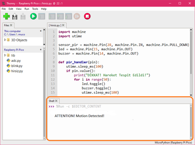

while True:
    led.toggle()
    utime.sleep(5)
Now we'll save and execute these programs on our Pico. The buzzer will now play and our LED will light up whenever a condition activates our motion sensor. When motion is detected, the word "ATTENTION! Motion Detected!" appears at the bottom of the Shell window.

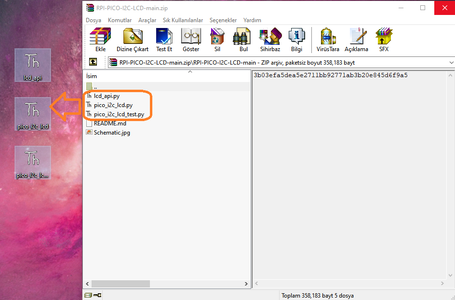

(2) To begin, construct your own circuit on the breadboard based on the design above. Now go to this library and get the appropriate library to use our LCD screen. To get the library, open the URL and click the green "Code" button. Then click the "Download ZIP" button.

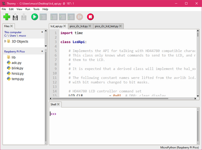

Open the downloaded “* .zip” file and extract the “lcd_api.py“, “pico_i2c_lcd.py“, “pico_i2c_lcd_test.py” files to the desktop.

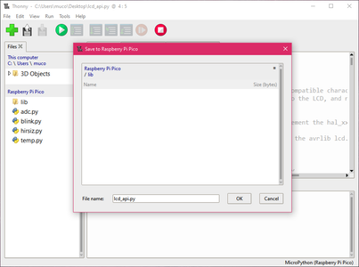

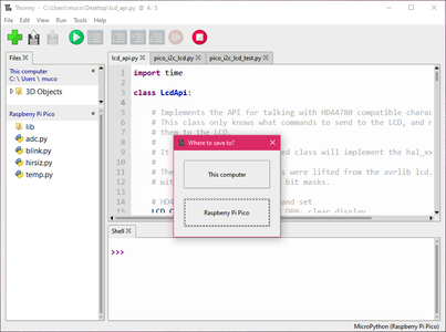

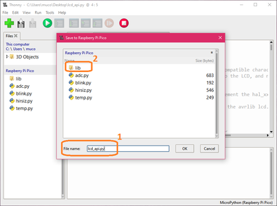

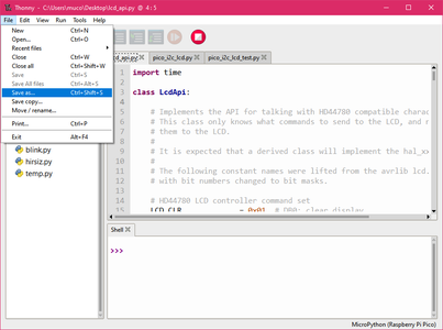

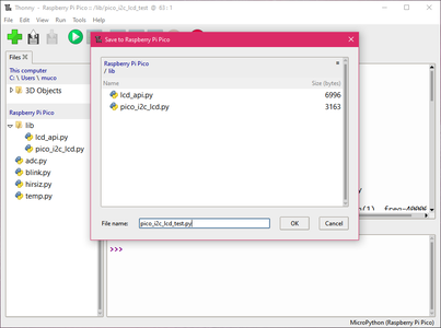

Open them in Thonny IDE by double clicking on these files that you extract to the desktop. Now save these files to the “lib” folder in your Pico in order, click on the “Files” tab on the top and then click on “Save as …“.
(3) It asks where you want to save the library file. You will choose the Raspberry Pi Pico. In this part, you have to choose the location where you want to save the file, then type the file name first. After that double click on the “lib” folder. Then click the “OK” button to save it to the folder.

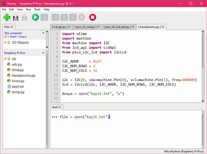

(4) Now that you have added libraries, you can open a new file by clicking the “Plus” icon on the top of a new Thonny IDE and write the following codes. When you examine the codes, first add the libraries as in other projects, then make the settings of our 2X16 LCD screen and create a new text document named “save” with the code “file = open (” record.txt “,” w “)“.
import utime
import machine
from machine import I2C
from lcd_api import LcdApi
from pico_i2c_lcd import I2cLcd
I2C_ADDR     = 0x27
I2C_NUM_ROWS = 2
I2C_NUM_COLS = 16
i2c = I2C(0, sda=machine.Pin(0), scl=machine.Pin(1), freq=400000)
lcd = I2cLcd(i2c, I2C_ADDR, I2C_NUM_ROWS, I2C_NUM_COLS)
dosya = open("kayit.txt", "w")
sensor_temp = machine.ADC(4)
conversion_factor = 3.3 / (65535)
while True:
    lcd.clear()
    reading = sensor_temp.read_u16() * conversion_factor
    temp = 27 - (reading - 0.706)/0.001721
    lcd.putstr("Temp: ")
    lcd.move_to(0,1)
    lcd.putstr(str(temp))
    dosya.write(str(temp) + "\n")
    dosya.flush()
    utime.sleep(2)

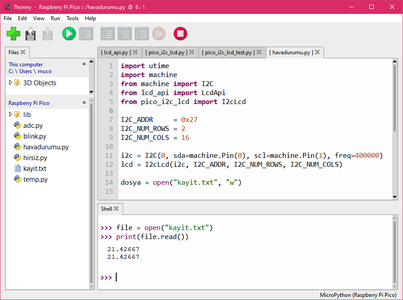

(5) Now save these codes to your Pico and run them, then press the “Run” icon at the top.

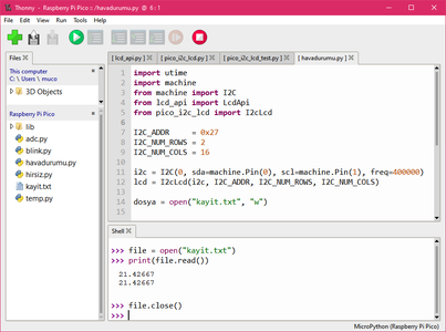

(6) It asks where you want to save the code. For the code to always run, you need to click on the “Raspberry Pi Pico” option and save it to our Pico. Type “havadurumu.py” as the file name and click the “OK” button. Now, you will be able to see the temperature data on your LCD screen and at the same time this data will be recorded in a text document.

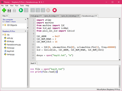

(7) Now wait for some data to collect, then click the “Stop” icon at the top to stop the code from running. Write the following codes in the Shell section at the bottom so that you can see the data have been saved.
file = open("kayit.txt")
print(file.read())
file.close()
(8) After typing the “print (file.read ())” code, you can see the saved data as in the photo below.

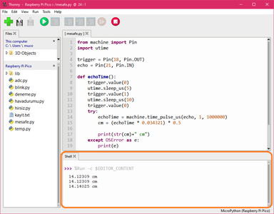

Step 6: Using of Distance Sensor
To begin, draw your circuit on the breadboard as shown in the picture.

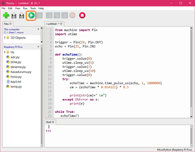

Now, in Thonny IDE, create a new file and write your code. When looking at the codes, you'll see that the first two lines describe the libraries, as well as the pins to which the distance sensor is linked. The function "def echoTime ():" was also used to write the distance measuring function. You've set the distance measuring function to run every 5 seconds, as stated by the while loop.
import utime
trigger = Pin(18, Pin.OUT)
echo = Pin(21, Pin.IN)
def echoTime():
    trigger.value(0)
    utime.sleep_us(5)
    trigger.value(1)
    utime.sleep_us(10)
    trigger.value(0)
    try:
        echoTime = machine.time_pulse_us(echo, 1, 1000000)
        cm = (echoTime * 0.034321) * 0.5
        print(str(cm)+" cm")
    except OSError as e:
        print(e)
while True:
   echoTime()
   utime.sleep(5)

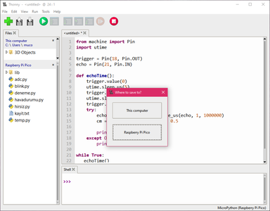

Save and execute these scripts on your Pico by pressing the "Run" icon at the top.

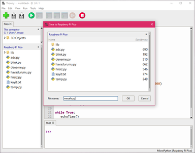

Write “distance.py” as the file name and click the “OK” button.
You can now see the distance in the Shell section of the Thonny IDE.
