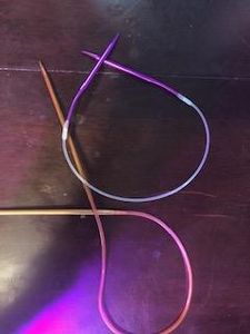

1. Start with a figure 8 cast on. This seems tricky but it works amazingly well. Start with the ends of two circular needles next to each other held together in one hand. Slot the end of your yarn with about 3 inches of end hanging down between the two ends. You want to tightly hold the needles so the yarn is gripped between them. Wrap in a figure 8 pattern around each needle so that you have 12 wraps on each needle (24 stitches total with both needles). Try to keep everything as tight as possible at this stage (though you can tighten the stitches later after you have a few rows knit).
2. The needle that the yarn ends up behind is going to be your first needle to knit on. The needle that is going to be second needs to get out of the way so gently slide those 12 stitches to the cable part of the needle keeping in mind that the loose end is going to want to escape since there is no knot holding anything in place. I grab that end with my pinky to hold it – you could also clip it with a small binder clip to keep it in check. Knit through the back loop of these 12 stitches since they are essentially backwards on your needle. The important part to remember is that you NEVER knit with separate needles. This is why it helps to have two differently colored circulars so that you can instantly tell you have the wrong needle when they are just hanging there. ALWAYS knit from the same colored needle. Now that you have knit one needle slide your other needle to where your yarn left off and knit through those 12 stitches. From now on think of these as the top and bottom of your sock tube (Needle 1 and Needle 2).

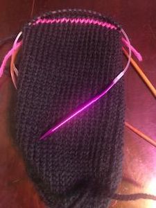

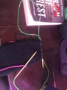

1. Take the waste yarn and after knitting with N2 go back to the start of that row by sliding the stitches back to the other end of the same needle and knit with the waste yarn (it’s important that this is a different color yarn so it’s easy to see where it is). Now knit N1 just like normal. Knit N2 with the regular yarn over the contrasting/waste yarn you knit. You will see this weird stripe in your sock. Don’t worry – that is just a place holder until we come back to knit the heel.

1. Here is where you can make the sock as tall as you would like. If you have more than 220yds of yarn to play with you can go nuts - though I’m not going to explain calf shaping here - so keep that in mind. A more crew length sock will be about 45 rows from where you have your waste yarn placed - start to work a rib pattern for a few rounds. K1P1 works well. You really can start your rib stitch wherever you would like. In this case I knit 15 rows and then started the k1p1 rib. When you bind off your stitches you want to be very loose – use a needle at least 2 sizes larger in this case an 8 – 5mm. There are many other ways to get a loose stretchy bind off –google them if you like. Cut the yarn with a small tail after binding off.

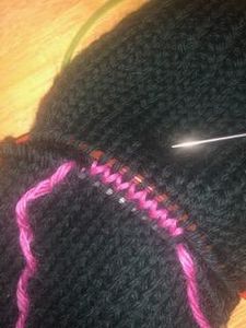

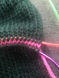

1. Now that you have your happy little tube you need to add the heel so it will fit to your foot. Take one of your needles and fish it into the row of stitches ABOVE your waste yarn. You want to make sure that you grab each stitch at the same angle and only pick up one side of the stitch. Knit stitches are like little letter V's and you want to only grab one side of the "V". You should have 22 stitches that you put onto waste yarn so you need to pick up 22 stitches on N1. Do the same thing on the row BELOW your waste yarn. You will have a bit of a yarn sandwich here. N1 above with 22 stitches – the waste yarn in a different color – and then N2 with 22 stitches.
2. Remove the waste yarn. You can pull it out stitch by stitch or cut it – being very careful not to cut your working stitches. You should now have a hole with stitches on both needles.
3. Pick up an extra stitch on each end of your needles. This helps to keep the heel from having any holes where we are joining yarn. So you would have 24 stitches on each needle.
4. Join your yarn – the same as what you cut when you bound off at the ankle – or a new color. You do you.Pay attention to the way the stitches sit on your needles. My N1 went the “right” way but N2 were “backwards” so I had to knit through the back loops to get them to sit properly and look right. If you don’t do this you will end up with a weird ridge. It may not bother you but it bugged me so I made sure to twist the stitches so it looked right. Knit around N1 with the yarn you choose for the heel – same for N2.

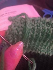

6. Now we need to bind off the heel. I use the kitchener stitch because it’s neat and does the job better than any other method I’ve found. It takes some practice to get it right but once you master it – you’re golden. Start with the yarn coming from the back and scoot all of the stitches to the end with both tips together (purl stitches inside facing each other) on the right. Cut your working yarn with a tail about a foot or so – basically take 3 times your stitches remaining in length. Thread this onto a yarn needle. With your needle go through the first stitch in front like you are going to purl. Leave it on the front needle (N1). With the yarn needle go through the first stitch on the back (N2) like you are going to knit. Leave it on N2. Tighten up the yarn but not too snug. This was the set up. Now you can get into a rhythm. From the front go into the first stitch like you are going to knit and remove it from N1. Go through the second stitch on N1 like you are going to purl but leave it there. On N2 go into the first stitch like you are going to purl and remove it from N2. Go through the next stitch on N2 like you are going to knit but leave it there. Repeat. The sequence is like this: N1 K remove, p leave, N2 p remove, k leave. Basically you simulate knitting and purling into every stitch with this yarn needle. Once you get to the last two stitches – one on each needle –you should have done the purl and knit one time before and so you can just knit and purl them off each needle.  If this sounds confusing there are some great youtubes showing exactly how to do it.
