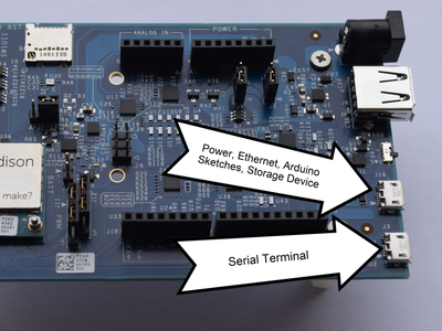

Step 1: Connect Your Edison
the first step is to plug your Edison to your computer via the 2 usb or otherwise to the central usb and to the wall.

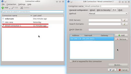

Step 2: Setting Up Your Pc Network Configuration
First of all you need to enter in the network editor and you'll see the wired connection (the name usually is something like "wired connection #") created by the Intel Edison.
Then edit the wired connection and move to the ipv4 tab, and set the address selection method in manual mode.
After that you'll be able to modify the network IP address, set it as 192.168.2.X (range from 1 to 254 don't use the 192.168.2.15 because this belongs to the Edison board by default) and set the Netmask 255.255.255.0 as the image shows, then click on the OK button.

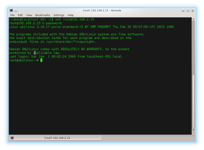

Step 3: Connecting to Your Edison Via Ssh
Now you should be able to connect to your Intel Edison via Ssh by typing:
"ssh youruser@192.168.2.15" if you have never configured your Edison use root instead of youruser "ssh root@192.168.2.15" after that I suggest you to run a "configure_edison --setup" command.

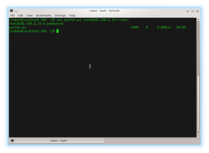

Step 4: Trying to Copy a File From Your Pc to the Intel Edison by Scp
Type on your terminal the command:
"scp source_dir/source_file your_user@192.168.2.15:/dest_dir/"
If everything is ok you'll be asked to input your password and the file transmission message will be prompted on the terminal.
