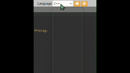

Step 2: Create Project and Set Language
When you're first logged into your account, the editor automatically shows a new project. You can also select "Create New Project" in the left side-bar. When in your new project window, select the C++ language from the drop-down menu in the top right-hand corner.

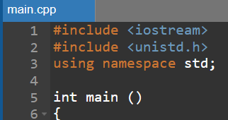

Step 3: Set Basic Syntax
For this program, we will use:
#include <iostream>
#include <unistd.h>
And will be including:
using namespace std;
After those are set up, it's time to set up your main function, which will be the only function used in this program.

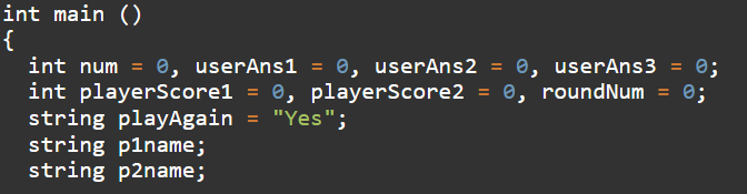

Step 4: Declare Variables
Your variables can have any name that makes sense to you.
Because we will be creating a number game, most variables will be integers.
int num = 0, userAns1 = 0, userAns2 = 0, userAns3 = 0;
int playerScore1 = 0, playerScore2 = 0, roundNum = 0;
You will need integers to:
  • (1) store the number that will be guessed
  • (3) store the player's three number guesses
  • (2) store player 1 and 2 points
  • (1) store the current round number
The next set of variables will be strings.
string playAgain = "Yes";
string p1name;
string p2name;
You will need strings to:
  • (1) store the response to "play again" question that will be at the end of the program
  • (2) store the players name

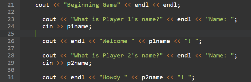

Step 6: Get Player Names
It's time to first implement those two player name strings. To add a little structure and character to the game, ask your players what their names are and store them for future use.

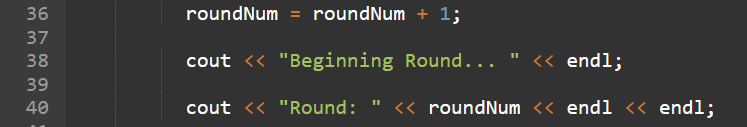

Step 8: Set Round Number
This program will display player and game stats at the end, the number of rounds played will be included. Start the round counter now.
roundNum = roundNum + 1;
and
cout << "Round: " << roundNum
allows for the round number to be added to with each round played and displayed when a new round is began.

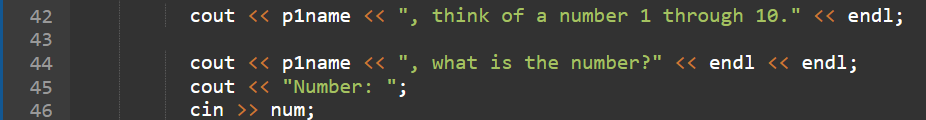

Step 9: Get Number to Be Guessed
Using the collected names, ask the first player for the number that player two will guess.
cout << p1name << ", what is the number?" << endl << endl;
cout << "Number: ";
cin >> num;

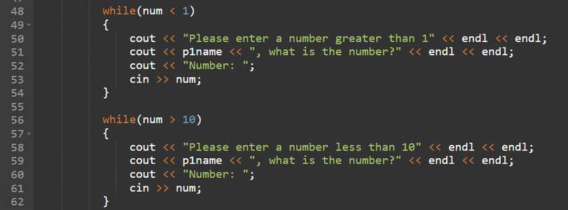

Step 10: Require Number 1-10
Sometimes, the player will attempt to enter a number that is less than 1 and greater than 10. To keep the game small and fair, implement an error catcher that will require the desired input.
