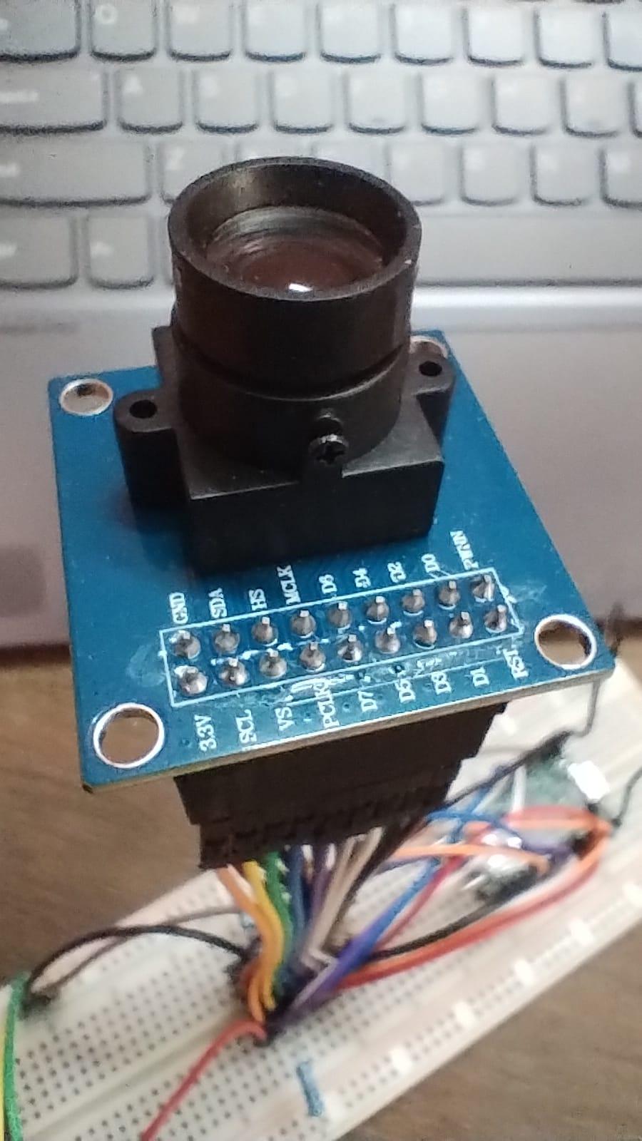

OV7670 (non-FIFO module)

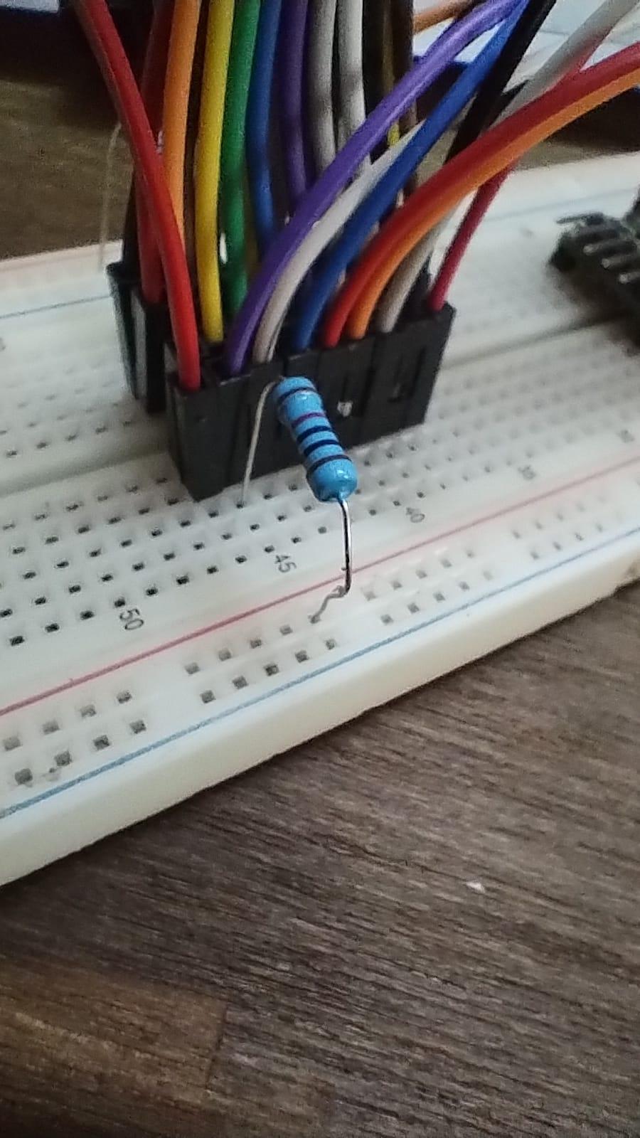

10K Ohms pull up resistor for SCCB connection

The main control pins on the module are X_CLK, P_CLK, V_SYNC, H_SYNC, SIOC/SCL and SIOD/SDA. Here are their functions....
the What...
-> an external clock signal from 5 MHz and 48MHz to the X_CLK pin from the Teensy
-> When V_SYNC pin goes high, it's the start of a new Frame.
-> H_SYNC pin's signal denotes the start of a new line (a horizontal axis of pixels)
-> P_CLK pin's signals denotes validity of available pixel data on the data pins (D0-D7)

->SCCB is similar to i2c hence used the pull-ups, to be noted when using multiple devices in the same bus.
Step 2: Connections
V_SYNC 4
HREF 5
PCLK 6
X_CLK 3
gpio6_psr port on the teensy 4.0 has been used for faster data reading
D7 20
D6 23
D5 22
D4 16
D3 17
D2 15
D1 14
D0 0
Reset 21
