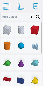

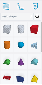

  • Shape Panel, which includes all of the basic design elements, such as text and cubes and spheres. (Exploring this box may be enjoyable because it has so many intriguing and occasionally adjustable choices!)
Step 5: Create a Shape
Let's begin by selecting a fundamental shape from the drop-down selection for geometry. Tinkercad will automatically position your chosen shape to sit atop of the workspace if you simply click and drag it there. Simply click and drag the corner marks (little white squares) on the image to raise or reduce the size of your shape.

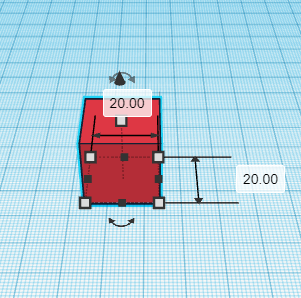

Step 6: Adjusting Width and Height
Select the red cube tool and drag it onto the workplane to start the design process.
Several boxes and arrows will show after the cube is on the workplane, allowing us to adjust the shape's size and orientation. You are welcome to click and drag the boxes to experiment with the cylinders' height and width.
Small white boxes with values will appear next to the top and bottom box selections surrounding the shape. These boxes allow users to enter the precise measurements needed based on requirement or preference. This is useful when modelling for 3D printing because it is frequently essential to construct an object within certain parameters.

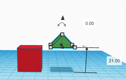

Step 7: Lifting Shapes
Drag a green roof across to the workplane after that. This form will be the house's roof and will rest on top of our cube.
We must raise the shape off the workplane in order to include it into our design in this manner. Click and hold the black arrow that is hovering above the shape to accomplish that. Once this arrow is clicked, slide the cursor upward and the shape will start to rise.
For example, if the roof is adjacent to the box, a visual marker will show next to the box informing users that the roof is at the height of the box. Tinkercad offers a variety of incredibly useful visual cues and indicators for alignment.
