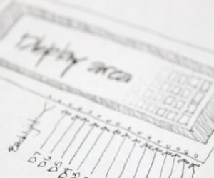

Check out the diagram 1.1 above. Yes, it's a bit messy, but I drew this while caffeine was flowing through my system! The SPI connector pin-out is to the left. There are arrows from this SPI interface block to the corresponding pins on the AVR Atmega32 microcontroller. There will be no need for fancy components to complicated this process, so don't worry--we are only connecting wires from the SPI device to the pins of the microcontroller.
Let's run through the connections between the SPI device and the MCU:
  • Top left SPI pin is connected to the MISO (Master In Slave Out)
  • Middle Left SPI pin is connected to the SCK (the clock pin)
  • Bottom Left SPI pin is connected to the Reset (Reset just does exactly what is says, and you can be sure we will talk about this pin later!)
  • Bottom Right SPI pin is connected to the GND (Ground, or zero volts)
  • Middle Right SPI pin is connected to the MOSI (Master Out Slave In)
  • Top Right SPI pin is connected to the VCC (+5 Volts, if you want, you can go check voltage requirements in the summary, or the HUGE manual, and trust me, this is not an easy read!).
