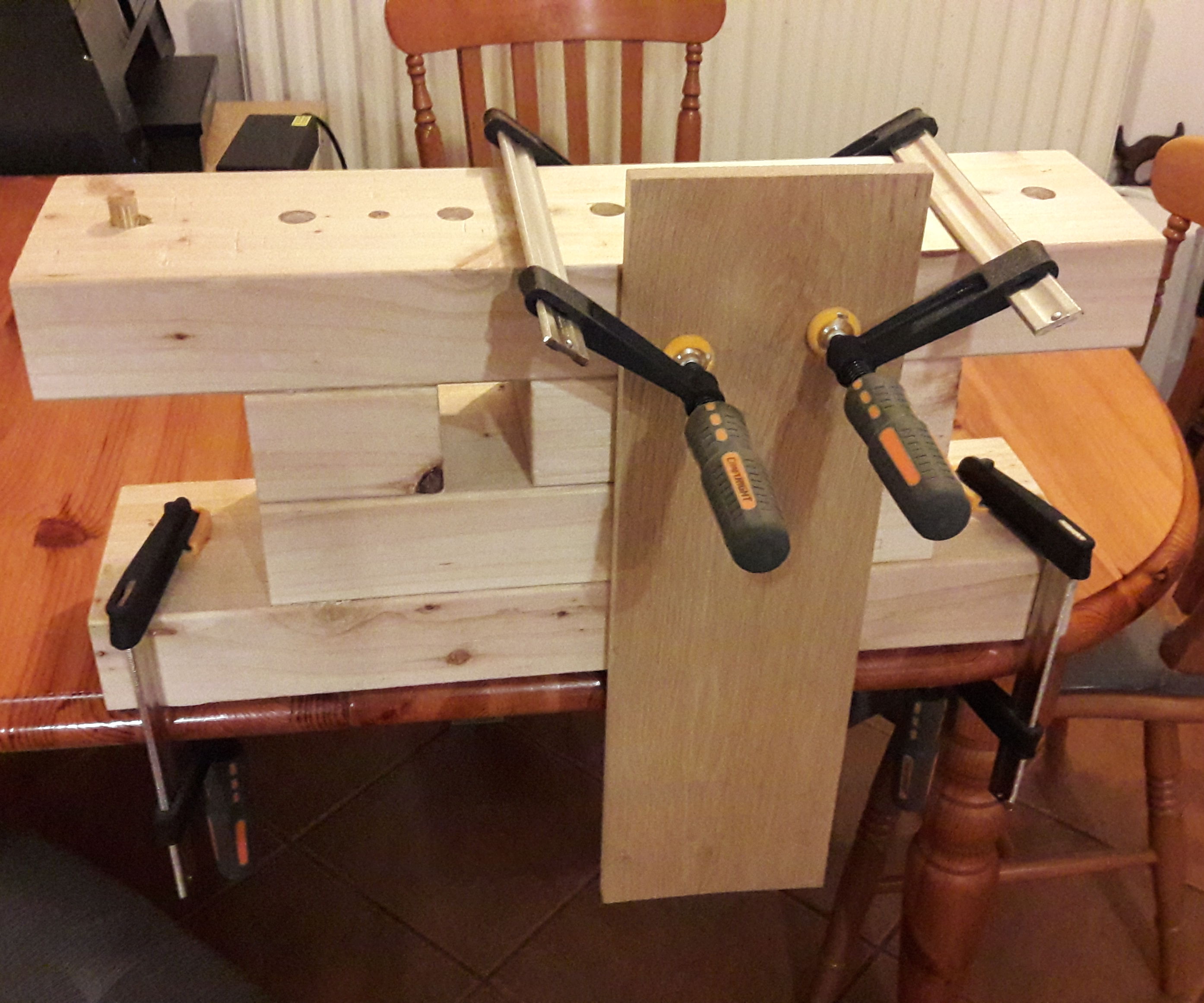

I had actually started this build before I built my bench bull work surface which you can see here. I realised pretty quickly that I needed something better than a workmate for this project! As well as a safe place to keep my tools, the aim of this build was to try new techniques and practice existing skills.
