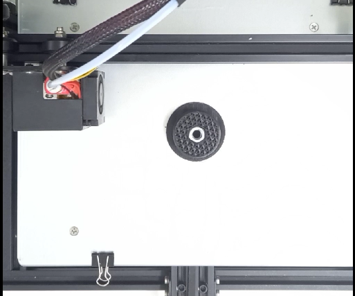

First of all we have to design this special tool.
We desing the timing belt tesnioner to the Tinkercad. We find two screws on the engine that would help to support the tensioner. We measure their distance and started experiment with the shape of the tesnioner in the Tinkercad
Step 2:
Then we slice the file in the Cura Slicer. We select typical settings as layer height 0.2mm, width 0.4mm, printing speed 50mm/s and increase the infill to 40% for getting a more strengh material
Step 3:
3D print the design.
Step 4:
Attach the printed tensioner on the engine and test the function of the timing belt. Now you can easily turn the engine in order to make the timing.
