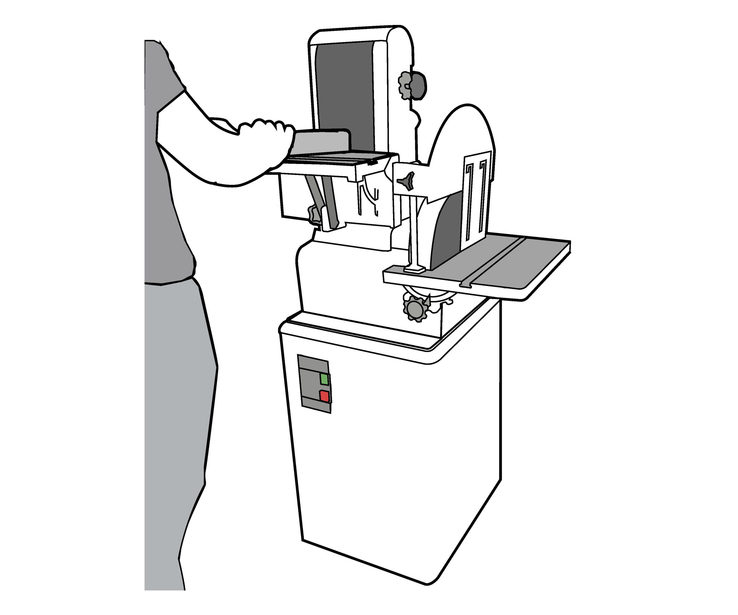

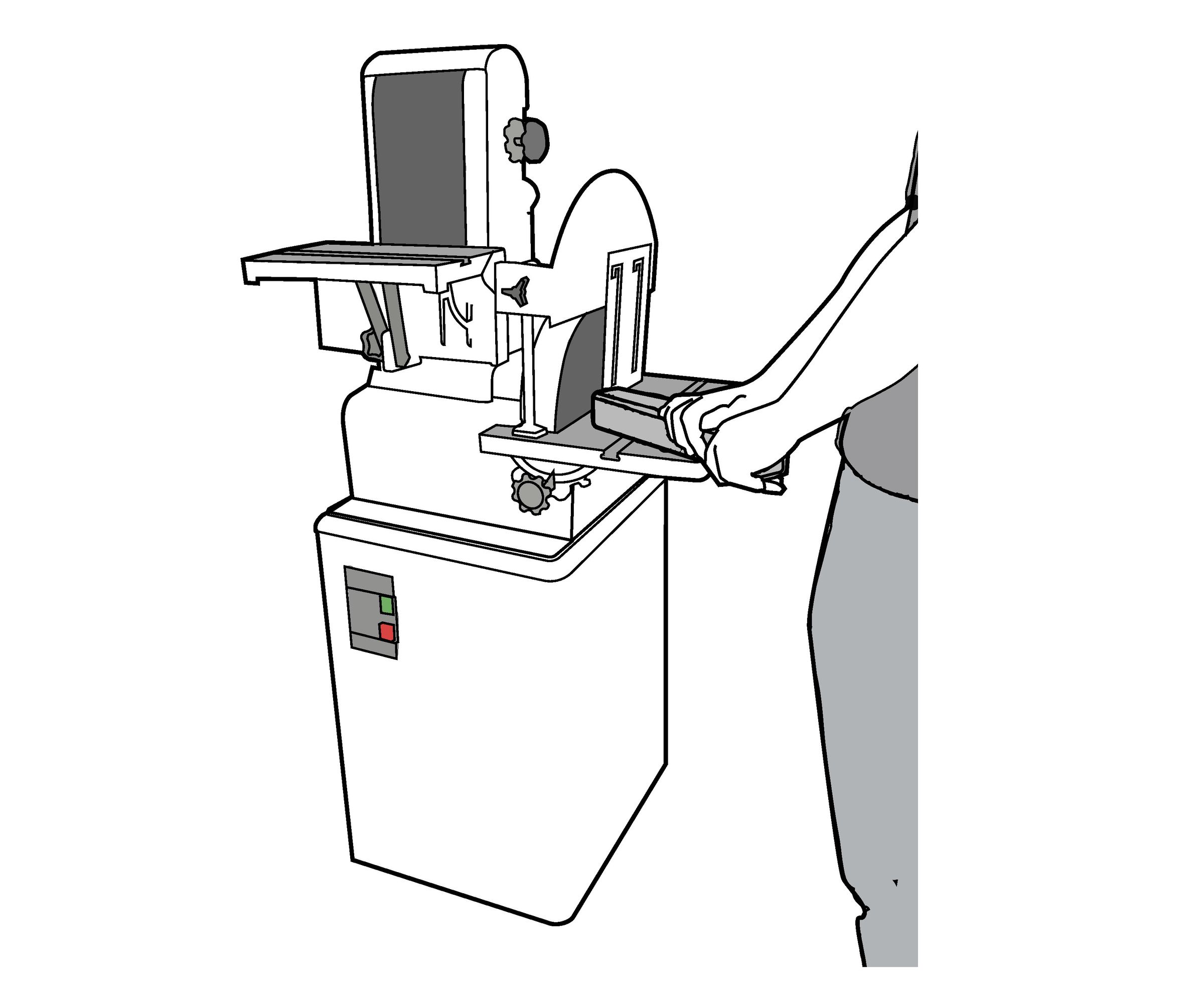

- The tables can be tilted in order to sand at an angle.
- See Shop Staff before making table adjustments, or refer to your tool's manual.
- Keep material flat on the table when working at an angle.
- If you can’t do this, use a hand-held tool to shape your work.

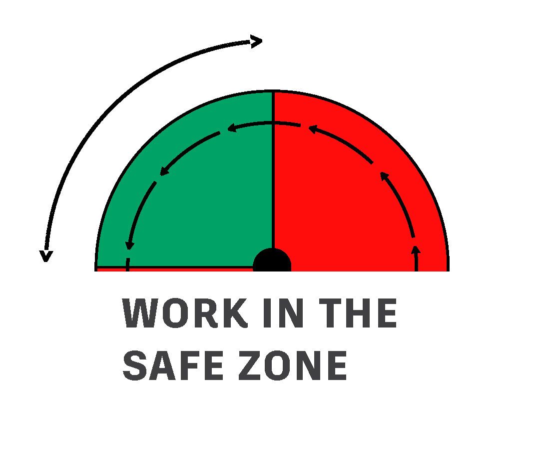

Only sand on the portion of the disc that is moving down, towards the table.
- Never move the guards.
