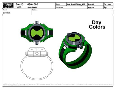

Step 1: Paper Template
I used official concept art as my reference during the whole project but I had to decide on a size scale to start with. The material I had available was a 8mm thick rubber sheet leftover from a previous omnitrix I made, I held the thickness up to my computer screen and changed the size of my reference image until the thickness of the first layer of the omnitrix matched (the layer that's green with a black stripe running along it horizontally). Once I got the size to where I wanted it I held a piece of paper up to my screen and traced over it in pencil, then made a precise copy of that and cut them out to use as paper templates.
