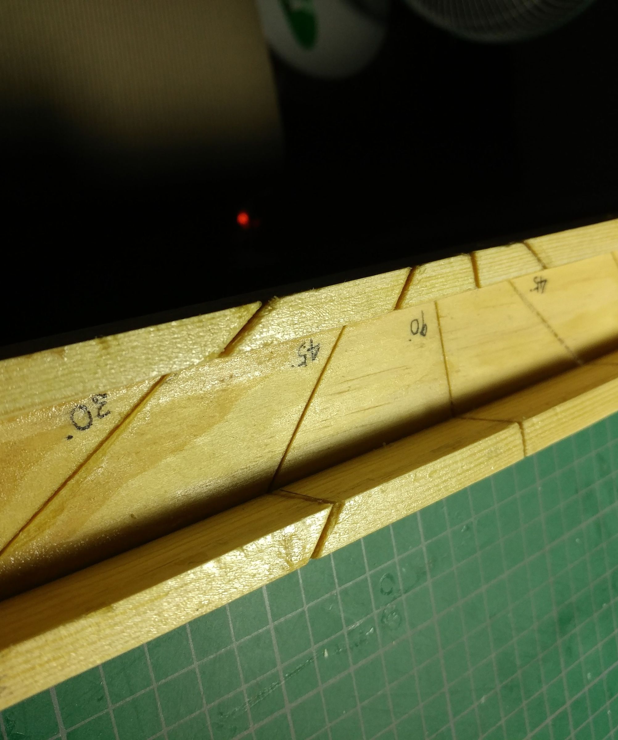

Step 2: Marking and Cutting
Because the polywood i picked is irregular edge , so i need to make 4 side of cutting piece straight line, mark 30 cm long , 18 cm wide line, and clamping the plate to start sawing ( be caution during cutting, i cut my finger twice!)
after polywood, mark the wooden block in even half piece(18cm), then cutting into 2 piece, and make one piece shorter than the other one in 1 inch .
Step 3: Drilling
Marking the drill point in even 3 section midpoint on 2 cutting wood blocks, then clamp the piece with the polywood on its edge( one piece after one after drilling) Use 4 mm diameter wood drill head, i setting the head on the hand drill.
I take red band on the drill head 35 mm away from the tip , to indicate the depth i have drilled
polywood surface face up , and block face down, then start to drill on the mark points( not to drill too much , i it will penetrate the block other side surface)
Step 4: Cementing and Screwing
the wood glue i used is Titlebond 3 ( purchased from internet)
first I apply the glue on both marking area of polywood and cutting wood blocks, then stick block surface onto polywood side, and clamping it with C-clamps,
During the glue setting, I started to screw the wooden screws one by one.
After setting of glue ( i wait 5 hours) , then repeat the process on the other side.
(Remember : each wooden blocks is on different side of polywood surface, don't make them on the same surface)
Step 5: A New Bench Hook Has Been Done
After 2 side has been setting, then your very own bench hook is ready to go
it feel very sturdy when i carve a little thing or using my cutting tools, it also can be immediate small work table on your desk, although the 4 edge is quit rough ( I don't have any sanding machine now) but for me , is quite practical in my place.
