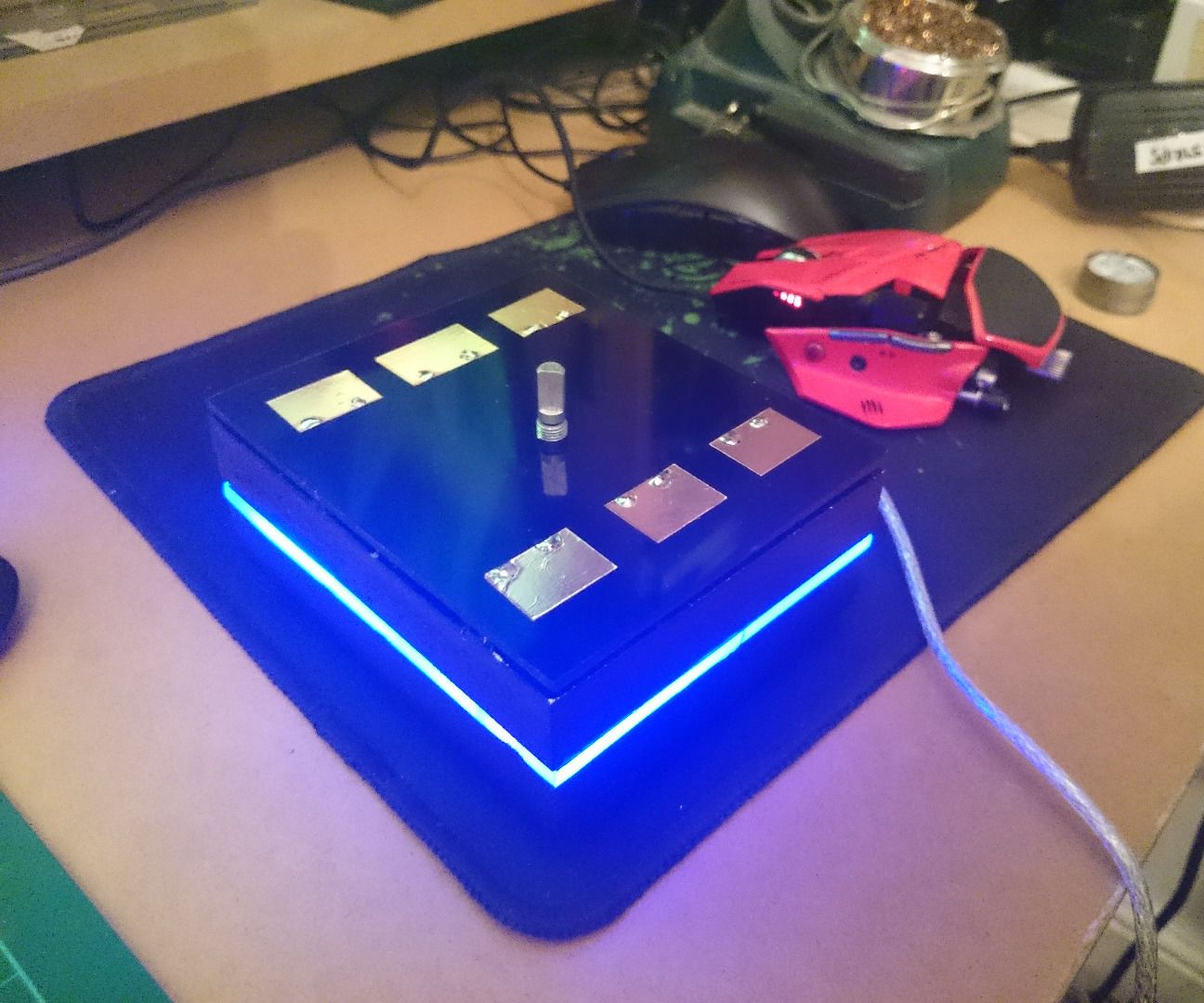

Step 1: Create Design and Wiring Diagram
I used Microsoft Publisher to design the front, side and back panels of the final product. I chose to have 4 x 4 way speaker terminals, and 6 banana posts. I also added a grounding post for an ESD wrist strap for later use. The large angel eye momentary switch allows the PSU to power up and down, and there are 4 LEDs to indicate that each voltage rail is working. Finally the LCD displays voltages and PSU status.
IMPORTANT: To power the ATX PSU without a motherboard being connected, we need to cross the green wire with ground (black wire) on the 20/24 pin connector. The green wire senses if it's OK to power all rails, so this needs to be connected to ground in order to power on. Read on...
Attached are the schematic files which I designed in ExpressSCH, and there are also images of the schematic.
The Arduino detects changes on the interrupt pin D2, which come from the momentary switch, and then sends a high signal to pin D6 which activates a transistor, that connects the GREEN POWER_ON wire to GROUND on the PSU to allow it to power up. When the switch is pressed again, a change is detected on interrupt pin D2 so pin D6 outputs low, breaking the connection to ground and turning the PSU off.
Once I had this completed, I figured out the entire circuit diagram. The idea is to gather all the same coloured wires from the output cables and group them together, but leave one of each colour cable separate for extras, such as the USB power and ground for the Arduino, and most importantly for the input to read voltages. The 5V standby cable is the PURPLE one which will power the Arduino and the LCD, and also the USB ports, so even when the output rails are turned off, the monitoring system will still be active and looking for an input on the interrupt pin (for the power on button), and you can charge your phone without having the entire power supply turned on.
The Arduino has analog input pins capable of reading a maximum voltage of 5V - since we have 12V and possibly more, we will be using voltage dividers to allow a safe input to the Arduino. See the diagram for the values that I used - I was able to get an accuracy of +-0.05V on all rail readings. This is because of the 10-bit resolution of the Arduino's ADC - I noticed that the higher the resistor values you use, the less accurate your readings, so I tried to choose resistor values that were in between and gave me the best readings I could get. Feel free to experiment with different values, but be sure NOT to input more than 5V on any of the Arduino pins as this will more than likely damage your Arduino!
Voltage dividers do what they say - they divide voltage. For more information on this, check out this link: Voltage Dividers tutorial and calculator I used this calculator for aiding with choosing the correct resistor values.
Since there will be 4 LEDs for each rail, measure the voltage on each rail and then calculate the resistor value required to have all 4 LEDs light up at the same brightness. I chose 10mA for all LEDs (I chose blue 3V forward voltage). Calculator: LED Calculator
In my case, my power supply required that I connect a 3.3v (orange) wire to the brown wire, which I believe is the 3.3v sensing rail, as I used an older PSU. But until I did this, the power supply wouldn't stay on - it would turn on for a split second and then power down. So try connecting the green wire to ground, and if it doesn't stay on then you may need to cross a brown and orange wire, if you have a brown wire. Else it should power up. I soldered the orange wire to the brown wire.
Also, there is a gray wire which will output 5V when the power supply is turned on i.e when you connect the green wire to ground. This gray wire connects to the Arduino's pin D4 and the software detects an input on the pin, and displays 'POWER ON' on the LCD if it detects 5V or 'POWER OFF' if it detects 0V. That is how we monitor the status of the PSU. I also designed a rotating square block which shows that the Arduino is running and voltage monitoring is being updated. You will see this in the video.
You may need a load resistor across 5V to keep the power supply on - I tried this on mine but as mentioned, I was required to connect the orange and brown wires, and the load resistor was not an issue. If you do need a load resistor, please make sure it is rated for at least 10W, and 10ohm. I personally would recommend you add it anyway, but I didn't add one. I will probably add one after having completed this Instructable.
In the third picture, you see a protoboard with terminal blocks - I used this protoboard to solder the voltage divider resistors on to, and wired them to the terminal blocks such that all the different rails could connect to it with a common ground for measuring the input. Unfortunately I do not have a picture of this, but the protoboard simply has the voltage divider resistors on there. Wires come out from the middle point of the voltage dividers and go to the respective Arduino pin (refer to the schematic).
Once you know how you will be wiring it all, upload the code to the Arduino, the connect it all up and give it a test run before you go on to build the case. Feel free to modify the case as you require. I left a space on the base on the left hand side as I want to add an LED tester, which I haven't done yet, but I will be doing.
PLEASE NOTE: before uploading the Arduino code you need to change some parameters in the code - see the next step.
The video shows how the control system works; this was before I built the case.

Step 5: Testing and Final Steps
So this is nearing completion now and requires some testing. I used a voltmeter to confirm all voltages were displayed as accurately as possible on the LCD screen, and as mentioned before, it was accurate to within +- 0.05v for almost everything. I noticed that with the variable voltage modules, the accuracy was very precise within the 3v - 7v range.
I didn't screw the top on, but I used industrial double sided tape - this is because I need to add the load resistor, and extend a 12V wire for the LED tester module which will be on the outside of the case.
Double check that all the voltages are correct on your voltmeter, and are to an acceptable accuracy on the LCD. Turn it on and off a few times to see it it responds!
I found that my momentary switch had a lot of bounce - the interrupt would ignore it. So in order for it to work properly, I would have to press the button firmly, and not quickly, if that makes sense.. Your mileage may vary!
Alternatively you could add a hardware debounce, or a software debounce - when I get a chance I will update the code to have a software debounce.
