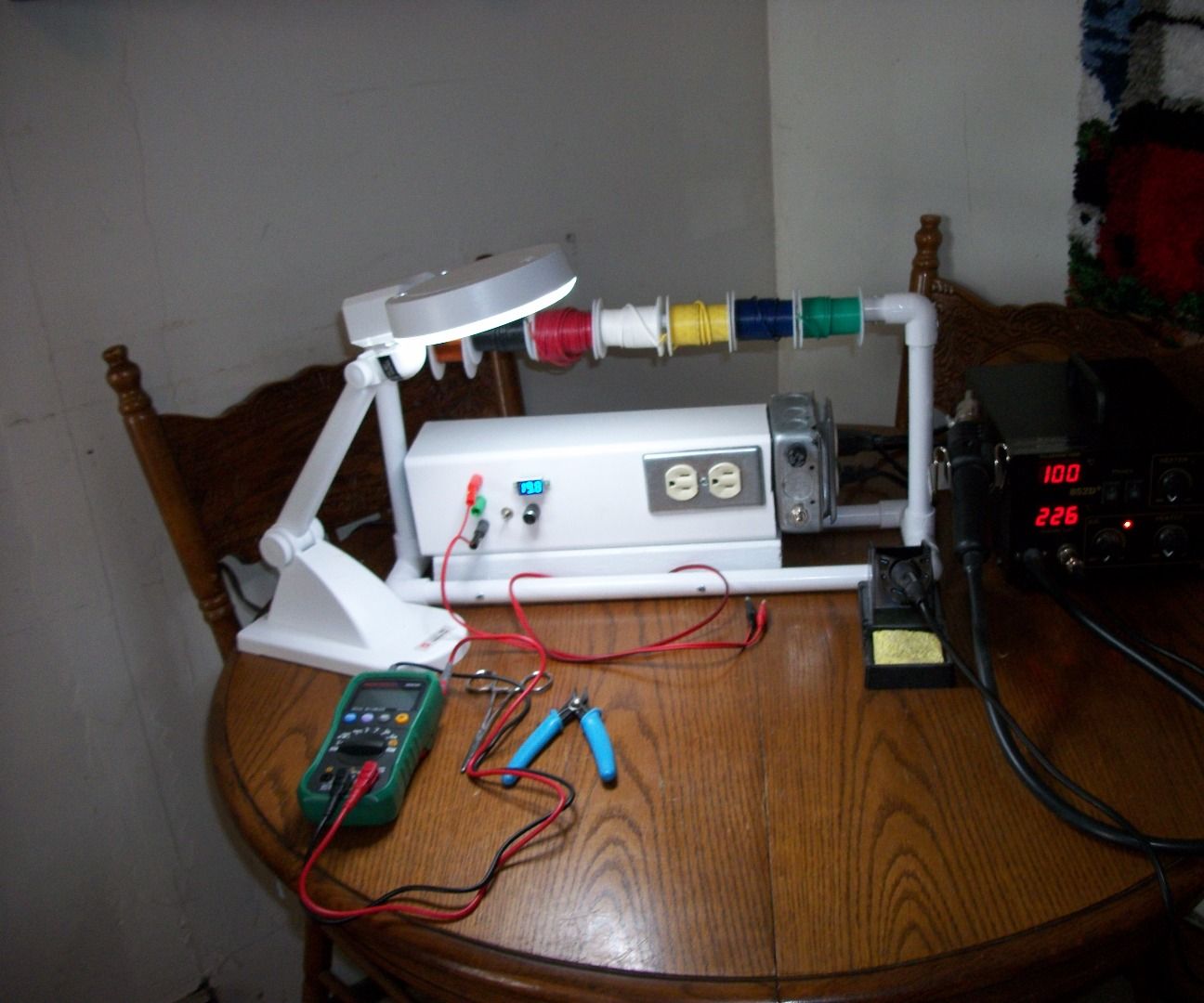

This is a Project that I undertook to solve the problem of limited space for my work area (I usually use the kitchen table for a work bench)
Step 1: BENCH POWER SOURCE
BENCH POWER SOURCE
I work with both solid state, and tube equipment on my bench (which isn’t terribly large). So I decided to assemble a power unit which could provide me the power (& safety) that I need without using up a lot of space.
The first thing I did was determine my needs:
> variable DC 0-~15 volt
> Isolated “MAINS” supply
> outlets for soldering iron, and light

Parts for the low voltage supply ( for variable 0-20 volt,
and 12 volt [primarily for the volt meter, and fan]).
The schematics were already in my collection ( schematic shows 1000uf, but I substituted the 2200uf)
Ø 4 – 1N4007 rectifier diodes
Ø 1 - LM317 voltage regulator TO220 case
Ø 1 – LM7812 voltage regulator TO220 case
Ø 2 – 1uf 35volt electrolytic capacitor
Ø 2 – 2200uf 35volt electrolytic capacitor
Ø 1 – 5k potentiometer (a ten turn Pot can be used for easier adjustment)
Ø 1 – 220 ohm ¼ watt resistor
Ø 1 – heat sink (for the voltage regulators)
Step 6:
I then carefully assembled all the pcs together in the
Plastic Case and put a 3” X 13” piece of Perforated Aluminum on the Back to keep loose items (like fingers) out of the supply, and the 4” fan in the open end (label out and “red to red wiring).
