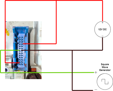

Step 3: Wiring
  1. Despite what many online sources claim, you only need to connect 4 pins on C1 connector (blue connector).
  2. These are circled red in the wiring diagram above.
  3. If you don't know how to count pin number, I have provided illustrations above.
  4. You can solder wires to PCB, or use jumper wires to connect to pins on the back side.
  5. Connect +12V power source to Pin 2 and 23.
  6. Connect ground to Pin 20.
  7. Connect your signal wire to Pin 7.
  8. Connect your signal ground to Pin 20 to provide a common ground.
  9. If you use alligator clips like I do, just clip the signal ground onto the power source ground's clip.
Once you're done, you should get something similar to the diagram I provided. At this point, change your frequency up and down, and the tach needle should move accordingly.
