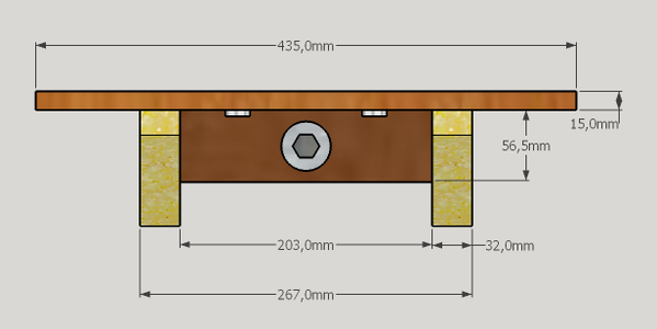

Before assembling we need to prepare the individual parts. Have a good look at the plywood and decide which side will be the top. Put some masking on the top and mark it as such.On the back of the plywood mark the middle with a pencil tick. This will later help align the table top with the rest.
Take the hardwood 203 mm x 58 mm slat and mark the center. Use the cordless drill and the 45 mm Forstner drill bit to make a 5 mm depth recess. This will be the pivot point for the table and the drill press. Use the 12 mm drill to drill all the way through the hardwood. This will be the hole for the M12 bolt to mount the table to the drill press.
Taper the two sides as shown in the diagrams. It is not strictly necessary but it looks very nice and also lowers the weight at the pivot point.
Clamp down all the pieces on the plywood as you would mount them (see the images). Mark the places for the holes and predrill the holes throught the first layer of wood and countersink.
Take everyhting apart again and put woodglue on the connecting surfaces.Clamp down all the pieces again. Now fix it all up for real using the woodscrews. Remove the glue squueze out with a wet rag. Make sure nothing is left behind so it won't show when applying the finishing layer.
Let the glue cure for 24 hrs or whatever time is prescibed by the manufacturer. Don't cut corners on this.. (been there, done that ... sniff...).
Mount your new table to the column of the drill press using the M12 washer and bolt. Mark the center of your table. Install the 20 mm - 30 mm Forstner bit and drill a clearance hole through the table.
