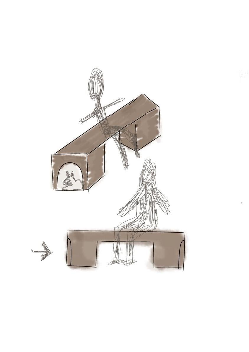

Introduction: Bench With Integrated Houses for Pets
This multifunctional bench combines design and practicality, providing a comfortable seat for people and a safe shelter for animals. We will detail the dimensions and provide a step-by-step guide to creating the project in SketchUp Online.

Step 1: Defining the Product Measurements to Start 3D Modeling.
The first step of the project was to define the dimensions. This initial stage was crucial to ensure that the multifunctional bench would meet the needs of both human users and animals, optimizing space while maintaining practicality in its design.
The dimensions were carefully planned to balance comfort, functionality, and harmonious integration into public spaces.
