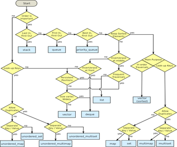

Step 2: Standard Template Library Sequence Containers
The Standard Template Library (STL) provides some alternatives to the traditional C array, the two explored here are:
- std::array - this is a fixed size array, the size is set at compile-time and cannot be changed.
- std::vector - a resizable array, an initial size can be set.

The image above is Mikael Persson's flowchart for STL container selection based on David Moore's earlier work. Stack Overflow: std::vector versus std::array in C++ has an informative discussion on the differences between the the two and C arrays.
