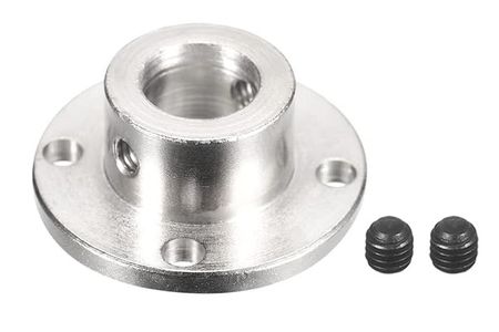

- Flange, to attach the disk to the motor shaft, e.g. https://www.amazon.co.uk/gp/product/B0BTHQNPQC/

Drill the holes to attach the flange, then attach it. It is important that the flange is positioned exactly in the centre of the disk. Depending on what bolts you use, you’ll need to counter-sink or recess the bolt heads on the front of the disk, so they don’t protrude.

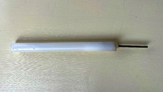

The flange is secured to the shaft using two grub screws, adjusted by a hex (Allen) key. I found that there wasn’t sufficient space between the disk and the cabinet to insert the hex key to tighten the grub screws. To solve this, I modified the hex key – it’s not pretty but it works. You’ll need a wooden dowel or plastic rod about 120mm long:
- Using a hacksaw, cut off the short part of the hex key. We only need the long part.
- Drill a hole in the end of the wooden dowel or plastic rod just big enough to push in the long part of the hex key and about 25mm deep.
- Apply some epoxy (or similar) glue around the end of the dowel from which the hex key protrudes and wait for it to set.
- Using the new tool, you can tighten the grub screws and secure the flange to the shaft.
