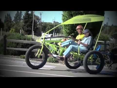

UPDATE:
Check out this super two-person trike my partner and I are offering on Kickstarter! I'll be bending the metal using a jig just like the one in this 'ible.
I'm a big fan of Atomic Zombie's builds. Except I like curved lines once in a while. I don't have access to a pipe bender, but I really wanted to introduce some curves to our latest project. Here's how you too can bend metal without any fancy equipment.

    Our current build, this tandem trike, uses a pair of 2" dia .065 wall DOM bottom tubes and it is so stiff we could mount a Harley or BMW motorcycle engine in it. It's ridiculously strong.
