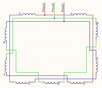

Step 7: Solder Wires
Solder the individually wound poles according to the diagram shown in the photo.
