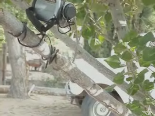

Introduction: Bendable Tripod
Go anywhere mount anywhere bendable tripod for Camera's and Camcorder's.

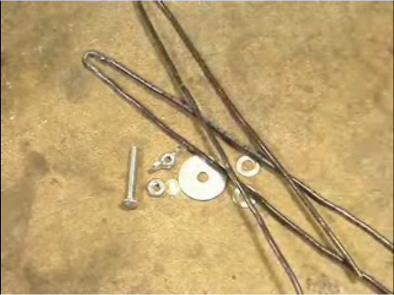

Step 1: Supplies Needed.
1/4" Bolt 2 1/2" long
1/4" Nut
1/4" Wing Nut
1/4" Washer x 2
1/4" Fender Washer
10 Gague Solid Copper Wire x 2 about 16" Long

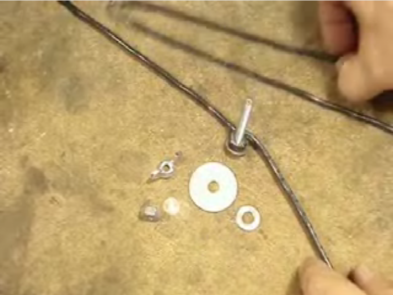

First, place a 1/4" washer on the bolt. Then wrap both pieces of wire around the bolt, just above the washer (make sure that the wire is bent in the middle around the bolt). It is important to wrap the wire tight. Then place another 1/4" washer on the bolt, followed by the 1/4" nut. Tighten the nut on the bolt, it's a good idea to use a pair of plyers and pinch the wire tight around the bolt. Once tight, adjust the legs, and it's ready to go.
