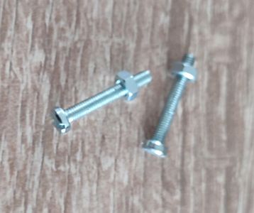

  • M3 screws, 20-30mm in length, 2 pieces.
  • M3 nuts, 2 pieces.

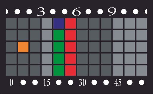

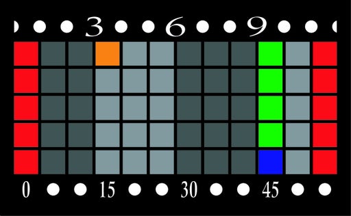

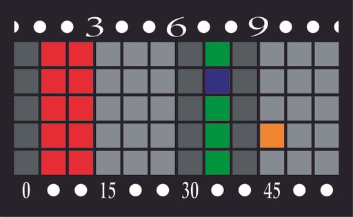

I know that there are many ways and methods to use such a display, a classic example being displaying the digits by scrolling them on the display. I thought of approaching the problem in a different way, and that's why I came up with the following solution:
The time is displayed using two colored columns of five LEDs each placed to the left and right of the hour point printed on the top band of the clock. An exception to this rule is 12 o'clock and 0 o'clock, which are also displayed on two columns: the first and last column of the display.
The minute is displayed in two stages: a column of 5 LEDs in the group of 5 minutes (the groups first minute is printed on the bottom band of the clock (for both minutes and seconds). In this column, the exact minute is then displayed in a different color.
The second is represented by a single square that moves from zero seconds to 59 seconds.
And to make things clearer, I will present some examples of the time displayed on the clock below.
It is 02:38:46 or 14:38:46
It is 05:24:07 or 17:24:07
It is 12:45:19 or 00:45:19

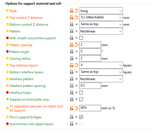

I used PrusaSlicer 2.5.0 and made some modifications to the support settings to make the supports removal easier. I took inspiration from the discussions here. I printed the grid lying down but the LED support vertically.
I also printed the box in the lying position and it took quite a while to remove the support material. Luckily, it was on the inside :)
The setting I used for supports:
After the parts were printed, I soldered the connection wires to the 7 pieces of 12-LED strips and pushed the LED strips onto the support (they are self adhesive). I mounted the LED support onto the box with the help of M3 screws and nuts. I made the connections to the Wemos D1 mini, between the module and LEDs, as well as the power cable (you can find the electronic circuit at the next step).
