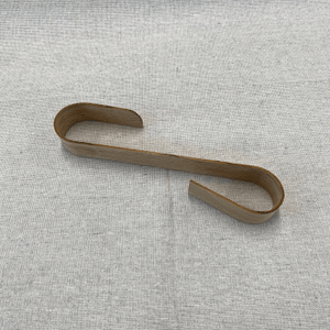

The video shows me bending some oak strips of about 1/16" to 3/32" thickness.
Clamp the jig securely to a workbench. Position the propane torch as shown and turn on the flame. You want the surface of the pipe nipple to come up to about 200 - 220 degrees F for optimal bending without burning. I use an infrared thermometer for measurement; this is especially helpful to find the location on the pipe that is in the right temperature range. Adjust the flame to maintain the temperature, and be sure the pipe does not get too hot during the bending process. If you have problems with burning turn off the torch, let the jig cool to 220 degrees F, and then use for bending. Minor burn marks can be sanded away after the piece dries. Never leave your jig unattended with the propane torch on, and use the jig only in a well ventilated area.
Take a soaked wood strip, wipe dry, and carefully bend over the hot pipe - wear gloves for protection. Take your time and don’t apply too much force; the wood might crack. Move the strip back and forth across the pipe. As the wood heats up and the lignin softens, the strip becomes pliable and bends easily. Again, go slow and easy. You may have to practice a few times to get it right. No matter, you will crack, break, or misshape some of the strips. For practice use wooden strips no thicker than 1/16”, it will help you develop a feel for it.
During the bending process the soaked-up water will turn into steam and soften the lignin; and the wood will dry. You may rewet the wood strip for further bending, especially with thicker strips.
The outside of the 1" iron pipe has a diameter of about 1-3/8 inch, so that is the tightest bend you can make using this pipe.
Once you have achieved (or approached) the desired bend profile remove the strip from the heat and clamp it to your template. Allow it to dry thoroughly. I found that with this method you have very little springback.
