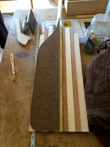

The blade sections are cut in different dimensions. The closer the the shaft, the thicker the blade section. The outer part of the blase and typically 3/8" thick by 3/4" wide and 14" long. The section next to the shaft should be about 1 1/8" thick by 3/4 \" wide and 15" long. Middle sections can be made from mahogany to add colour to the paddle blade.

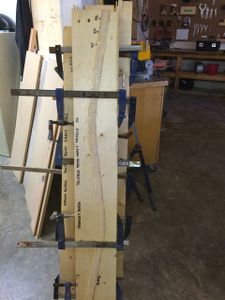

Step 4: Glue Up of Shaft Using Templates and Gluing Blade Sections
Coat each shaft laminate with glue, align then clamp between the forming templates. You can also glue together the pieces for the blade one side at a time and clamp to ensure the base is flat. Let the glue dry overnight.

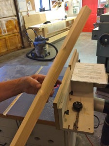

Step 6: Cutting the Shaft to Length and Cutting Mortise for the Handle
Using the tablesaw and tenon jig, cut an insert in the center of the shaft's end that will receive the handle. This will allow you to place a piece of hardwood perpendicular to the shaft and parallel with the blade. Glue it and filler blocks in place.

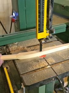

Step 7: Rough Shaping the Blade and Lower Shaft.
When the glue both sides of the blade are set, cut the central sections to taper toward the tip of the blade. This will save wood removal later. Use the belt sander to smooth both top and bottom of the blade. Now shape the shaft by tracing the profile of the blade on the shaft. Cut away extra wood so that the blade will fit smoothly against the shaft.
